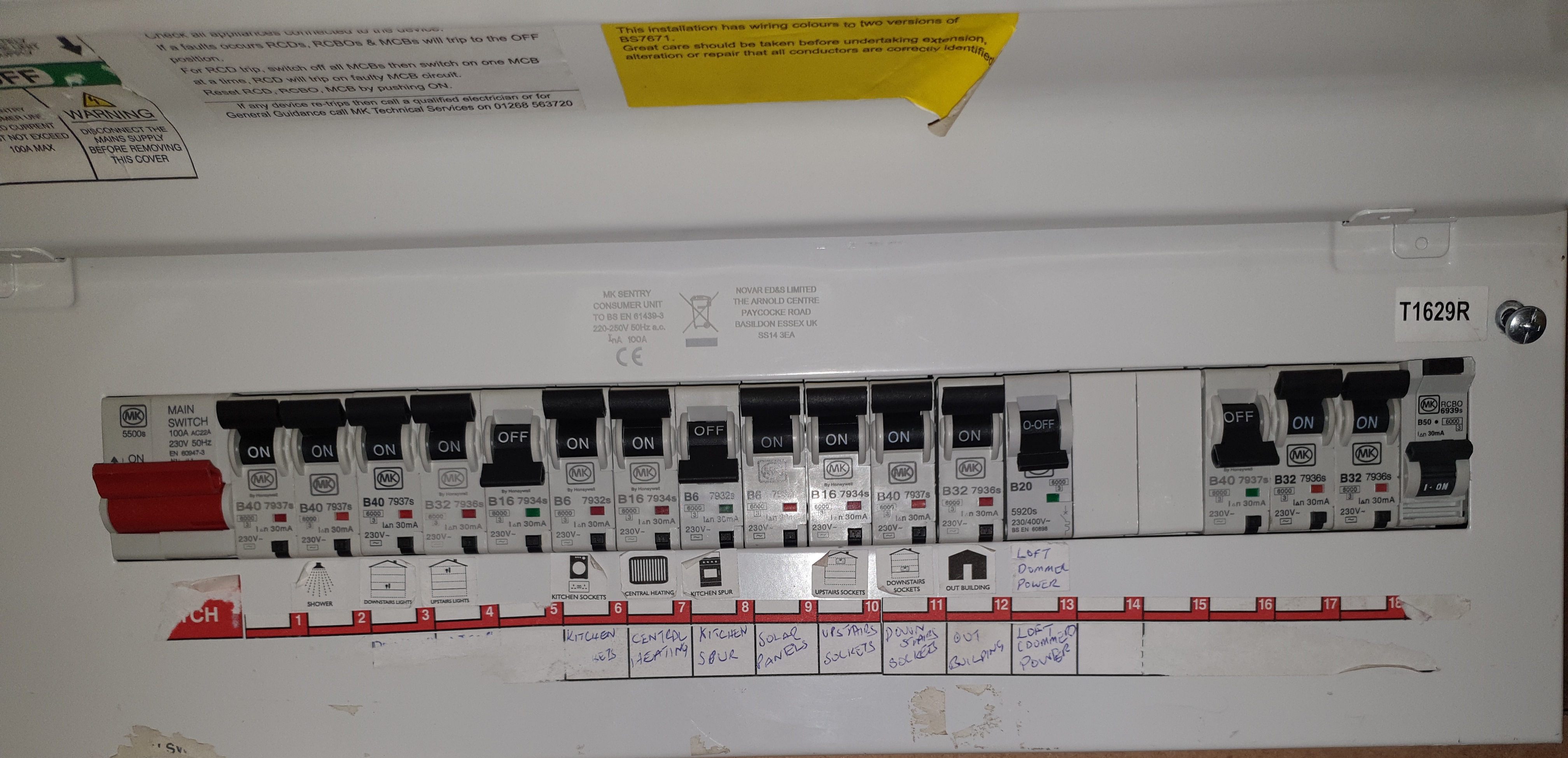

Hello just wanted to ask, my friend has done an extention, and new wiring, with new lighting, ring main, my friend has all rcbos in CU, and he has run the wiring, and contected to rcbos, but he has been told that the new wiring, i.e that the extention wiring should be rcd protercted, it dosent matter if each of the circuit is protected with rcbos,
i.e the lighting circuit is protected by rcbo and so is the ring mains and the cooker, does it still need rcd protection.
Any help would be really apprecitaed.

An RCBO is a type of Residual Current Device (RCD). Who has told 'your friend' of this 'requirement'.

Think of an RCBO as a combined MCB (providing overload protection) and an RCD (providing earth leakage protection) but in a single device.
Is it possible to show a pic of the consumer unit.

Well your friend is OK then - the system has RCD protection.
#1 and #4 are at odds with each other. Has this electrician actually seen the consumer unit.

Well this Electrician who is going to certify the installation ought to throw his tools away cus he doesn't know what he is talking about

Yes I can attach pictures of the CU, that have been send to me.

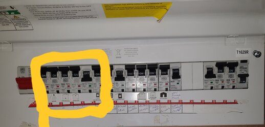

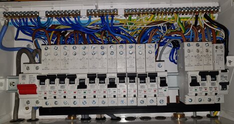

Top job, all circuits bar one have rcd protection by way of rcbos.

What is circuit 13 identified as.
Thank you, Yes he is waiting for the rcbo to come and then he will replace that one too, so no need of separate RCD in the CU, for the new wiring for the extension, as it gas RCBOs.
What's circuit #3 and is the cable suitably sized? Perhaps it's me, but it looks rather thin, compared to the other cables in 40A RCBOs.
He says it's from solar Pannels, which it protected by an isolater, it's a flex cable

It might be but I will have to check, if 2.5 then, he will have to reduce the rcbo to 32amps, correct
