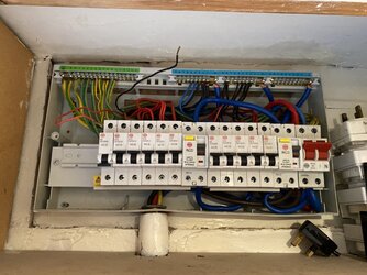

I'm caring for a friend and last night while sleeping on the sofa-bed an emergency system that had lost power was sending out a warning signal. Startling to say the least. The RCD had tripped and after some internet sleuthing I managed to isolate the problem to the ceiling lights. It was raining at the time, so there was a chance that water had somehow affected the earthing(?).
In the morning I've looked at around all 29(!) ceiling spots to see if there was obvious water damage - there isn't any. So we called my friends neighbour who is a handy man and electrician.
All 29 bulbs are on the same ring. Handyman said this is crazy. It's impossible to isolate where the problem is. For 29 bulbs there are 8 dimmer switches and 1 regular switch. Two of those dimmers have two dimmers on the plate so technically 10 dimmers in total. Some are old, some are new. The old ones don't work so well and the lights can flicker a lot (they're not LEDs), but if you find the sweet spot it's not a problem.
Anyway, handyman took a few of the spots out of the enclosures, but they seem to be wired within the ceiling, each having a thick grey wire from bulb to beyond where he can access. In an attempt to isolate the problem further he disconnected the live wires from all the dimmer switches, individually. We tested the MCB switch each time but even after all were disconnected it still tripped. He said this was odd and not good!
He tested the wires going into the fuse box with his multimeter and it seems it's reading at a high number when it should be zero. He said the brown live was too thin for the load, it's 1.5mm, and that the insulation has gone (somewhere) and touching the earth wire. He says the only way to fix this is to replace the wire entirely, with a thicker one. This will involve a few holes drilled into the ceiling to feed the new wire through.

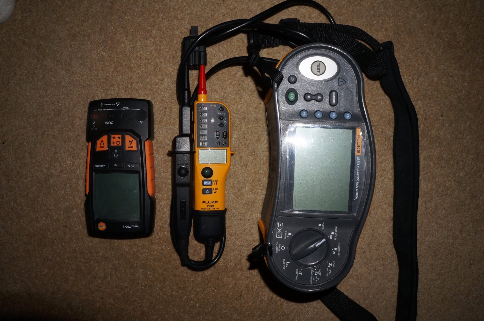

Yes disconnect the external lights from the circuit and see if the problem persists, that would be the first investigation a competent electrician would do, they would than use a MFT (multi function tester) to test insulation and continuity of the whole circuit, did the handyman have a MFT or just a multimeter, MFT's cost upwards of ÂŁ500.00 they are a bit more complex that a multimeter.

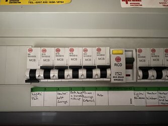

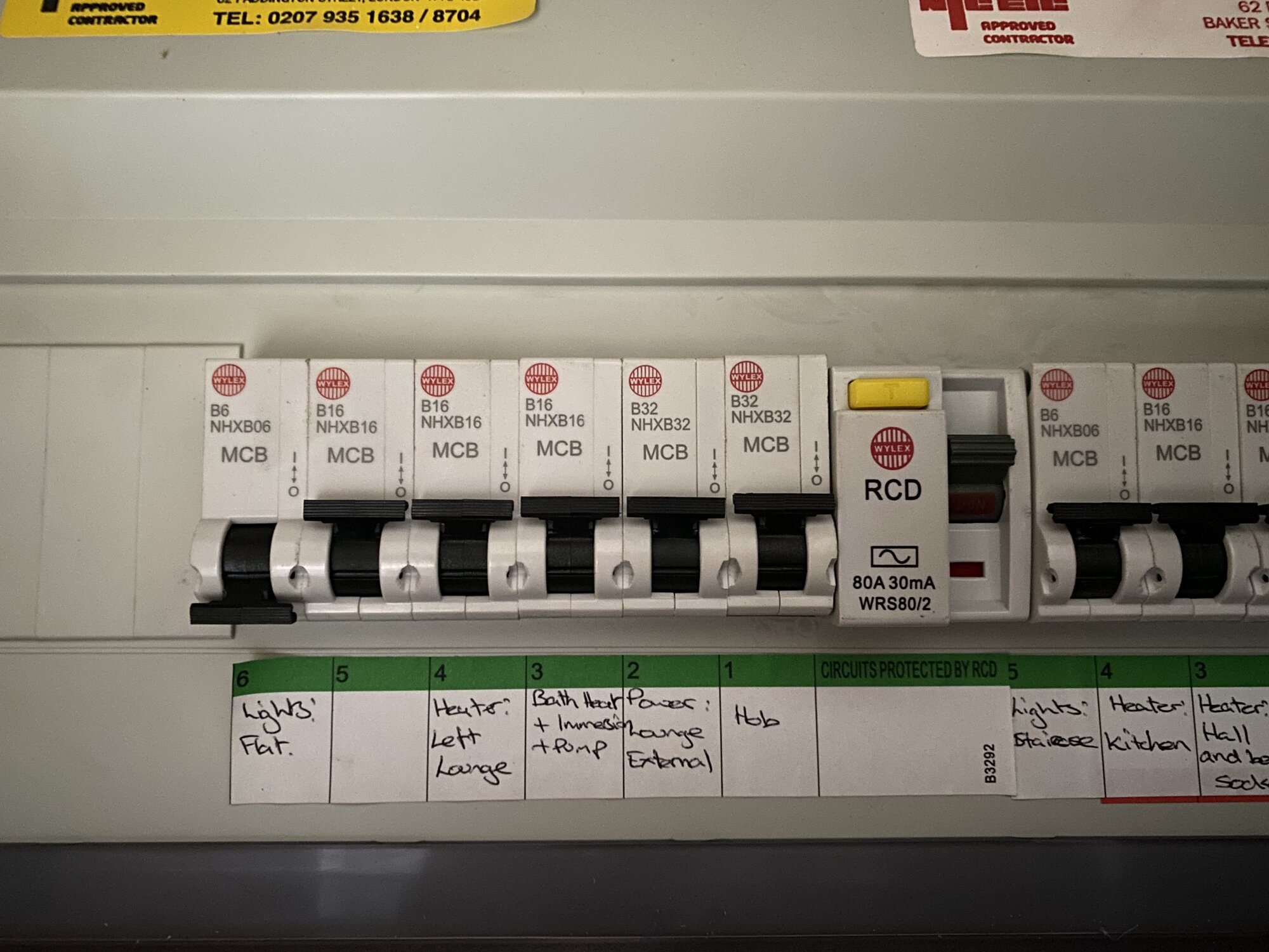

As per MikeJ, the cable size of 1.5mm2 is fine for a lighting circuit and it has a 6A MCB (from your photos) to protect it.
Yes the problem is likely to be an unwanted connection to E somewhere in the circuit. An Electrician would work to find this fault with their test gear. It’s just not warranted to re wire the circuit until all other possibilities have been examined.

The only multimeter he has was a longish yellow one, it wasn't as sophisticated as I've seen on youtube videos, but that's a layman's view.

You have ended up in a tricky situation here trying to do the right thing. The cable may or not need replacing but needs confirming by testing using an insulation resistance tester, it doesn't have to be a Multi Function Tester as long as the tester can carry out the correct test. Replacing parts and hoping isn't really the logical way forward.

To add insult to injury it seems the immersion heater isn't functioning properly!! It's on the same RCD circuit (along with the bathroom pump and heaters which both work as expected). The water is warm, but not hot, which is obviously strange. It seems too much of a coincidence not to be linked. But if they are linked, why would that fuse not trip and yet the lights do!
