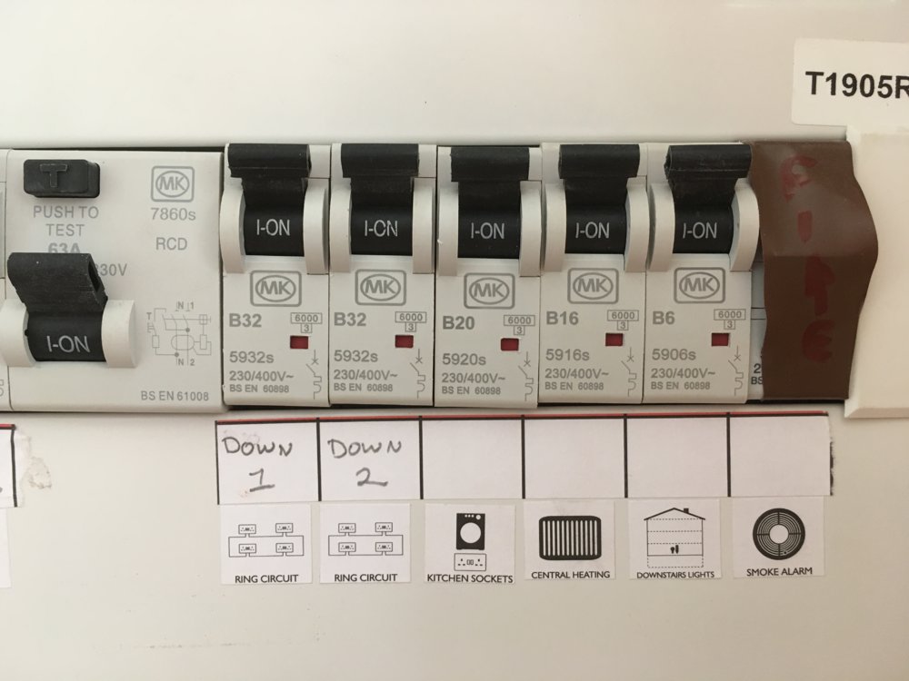

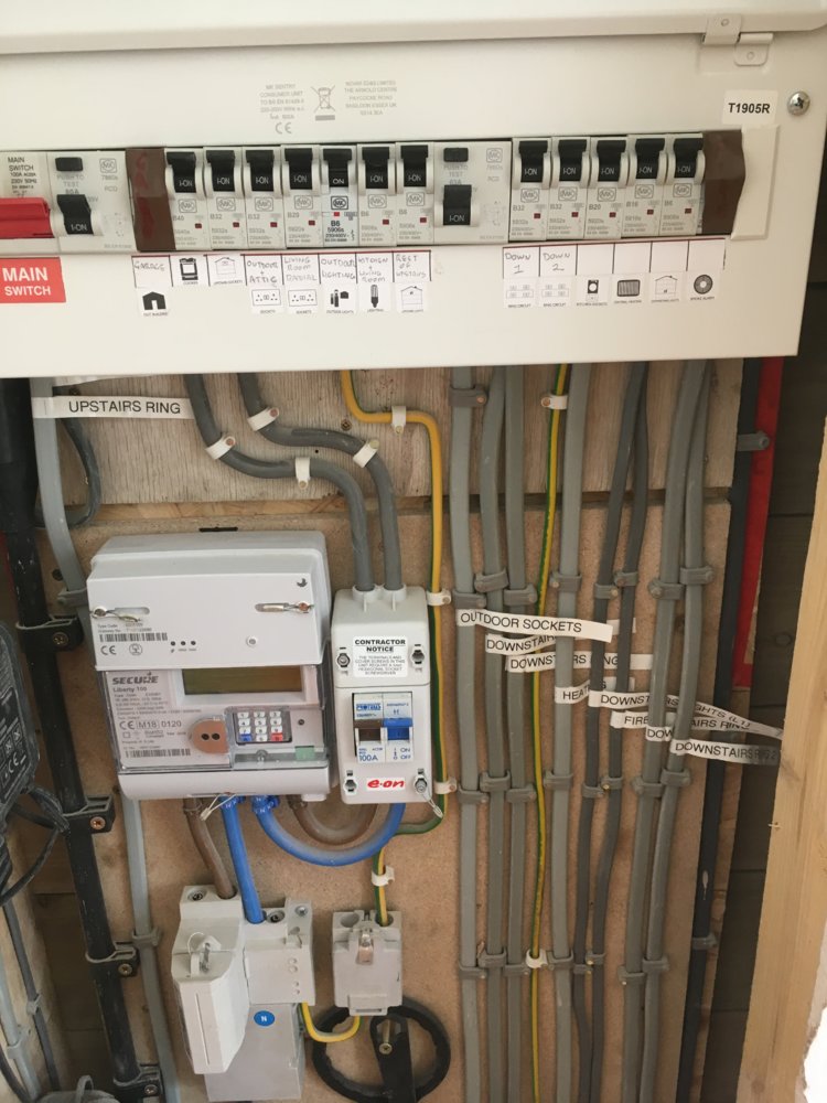

I’ve a new self build house that I’ve moved into prior to the lockdown in the UK.
100amp supply from Scottish power.
Within my Consumer Unit I’ve an 80A RCD which is serving the following:
B40 MCB (garage, not connected)
B40 MCB (oven)
B32 MCB (upstairs ring sockets)
B32 MCB (outdoor and attic sockets, both separate radials)
B20 MCB (living room radial sockets)
B6 MCB (outdoor lights)
B6 MCB (kitchen and living room lights)
B6 MCB (rest of upstairs lights)
And I’ve a 63A RCD serving the other half of the CU:
B32 MCB (Dn Stairs ring socket 1)
B32 MCB (Dn Stairs ring socket 2)
B20 MCB (kitchen radial sockets)
B16 MCB (Central heating, boiler and UFH)
B6 MCB (Dn stairs lights)
B6 MCB (smoke alarms)
Just before the lockdown my mate who’s a qualified electrician fitted a new range master oven with 6mm 3 core and that’s the only addition to the house in months now. The oven has two separate ovens and a grill. The second oven is now not working but this happened a few days ago and if just came back on.
I’ve unwired the oven from the CU and when I tried using a chop
Saw on the upstairs ring socket it tripped the 80A RCD again.
The Issue I’m having is the 80A RCD keep tripping and it does so even if I use something on the other side of the CU, ive used an angle grinder on the down stairs ring and it works fine but It trips the 80A RCD which should be independent.
I’ve done a continuity test on all rings and everything is Ok.
The RCD is periodically tripping now with nothing plugged in.
This started three days ago and when I couldnt Get it to work I left it along and it worked fine again for 24 hrs and now faults again.
On occasion when I turn off the mcb’s, the rcd won’t reset.
Ive also traced all cables the lives and neutrals are all going to the correct RCD.
Any help would be appreciated. I’ve asked a few mates who are sparks but my mate who’s done all the wiring is self isolating with his mother who’s not well so I don’t want to bother him.

Strange "unrelated" tripping of RCD is often down to a neutral to neutral fault, or more likely a neutral to earth fault. In both cases there my not be much voltage present so not much current flows, but if something large is used or an unfortunate combination of things, enough can flow to trip the RCD action (as it sees N != L).
Far more serious are cross-connected rings but probably not here (i.e. "ring 1 end 1" is accidentally paired with "ring 2 end 1or2" and not with "ring 1 end 2").
[automerge]1588003182[/automerge]
If you test the RCD a couple of times with all load MCB off is it reliable to trip and reset?
A faulty RCD is always a simple explanation, but it tripping on an unrelated circuit sounds a lot like a neutral to earth fault somewhere.
Thanks for answer, any tips for carrying out some checks?
Surely the ring ends couldn’t be mixed up as you describe as the continuity test on all rings came back OK and I’ve been using heavy load equipment for months with no issues until three days ago.
Tip No. 1 be very careful to isolate everything!
You have a separate isolator switch so you should not have to worry about exposed permanent live bits near the incoming switches.
If you can get the neutrals out (in pairs for ring circuits) then check if there is any resistance to earth, that is the most likely reason. Note the fault could be in something that is plugged in, in which case it would depend on the 13A socket being switched on.
Ideally you would test the house wiring independently by unplugging everything first, and if nothing found then check the appliances for earth faults.
agree it's most likelya N-E fault, probably on the circuits protected by the RCD that isn't tripping. only occurring when a fair size load is applied. an exhaustive dead test on (disconnected) neutrals to E will find the fault.

You should see infinite resistance from N to E with the input isolated. If you see any resistance reading below 1M ohm then there is a fault.
To make life easier, manually trip the RCDs and check if that has isolated the N-E fault to one RCD's set. If present, it will probably be one of the 80A's set as it is tripping.
If you have established there is some fault between N and E then you can proceed to disconnect all appliances (realted to the RCD set where there is a fault) that it is practical do do, in order to establish if the fault is in one of them. If you still see an E-N resistance below 1M then the fault must be in the fixed wiring or a non-detached appliance.
At this point you can open all MCB and try lifting each circuit's neutral(s) at the CU to check those lifted wire(s) to E. When you disconnect the circuit with the fault you should see the remaining N to E go open (above 1M) and see the fault resistance on the wire(s) you have disconnected (so from them to E). For each that checks out OK replace the neutral(s) at that point to the hole they came from in the N terminal block to avoid later confusion.
But if you find a disconnected N that is going to E, double-check that the remaining N are now isolated in case you are very unlucky and have a double fault!
Thanks,
Another novice question, to test the resistance do I need to set what ohm level to test, I’ve tried to send a photo of the multimeter but it won’t upload for some reason but you can see on the manual that I put the link up of what options are available. Also on page 9 in the manual it says to select the desired range.
Apologies for the novice question. Thanks.
Probably you will see the fault on most of the ranges, but as the conventional limit for an insulation fault is 0.5M or 1M (but at high test voltages) you could initially set it to the 2M range, if it reads very low then check again on the 200 Ohm range.
Does it matter if the red or black lead goes to N or E, are they interchangeable? I’ve done one test to check if they were interchangeable and it would appear so.
Test 1
Testing at 2M
Both RCD in the on position
Red probe to N
Black probe to E
I’m getting readings that continue to go up starting well below 1 ( 0.3) up to 1.3 if I hold the probes long enough but always going up with some fluctuations.
Test 2 (probes swapped)
Testing at 2M
Red probe to E
Black probe to N
I’m getting readings that continue to go up starting well below 1 (0.4) up to 1.3 if I hold the probes long enough but always going up with some fluctuations.
Test 3
Testing at 2M
80A RCD in the off position
63A RCD in the on position
Red probe to E
Black probe to N
I’m getting readings that continue to go up starting at 1.1 and go up and past 1.2 within a matter of seconds compared to the minutes it took for the pervious two test, again always going up with some fluctuations.
Test 4
80A RCD in the on position
63A RCD in the off position
Red probe to E
Black probe to N
I’m getting readings that continue to go up starting at 0.9 and go up and past 1.2 within a matter of seconds compared to the minutes it took for the pervious two test, again always going up with some fluctuations.
Conclusion:
There doesn’t appear to be any difference in the results of any of the four test and so I’m still confused as to what the problem might be as all were reading above 1 and continuing to rise.
I’ve tried uploading photos of the test results but not had any luck again
It should not matter which way round for a simple short circuit style of fault. What you see with it initially low "resistance" and then rising is typical of charging capacitance (the meter measures the current flowing, so with a capacitor it is initially large and then drops as its voltage increases towards that of the source due to the accumulated charge).
Now all cable has capacitance, but I'm a little surprised to see enough of it to show up in your test but have no experience with your type of meter to know if that is reasonable or not.
The last thing you would try is a similar set of tests (both directions) using the diode check (arrow symbol) to see if anything electronic appears. Otherwise it looks as if the fault might be intermittent or not as simple as a E-N short (though it really looks like it).
Again if you had access to a proper insulation tester to check as 250V it would answer the question in a more certain manner.
