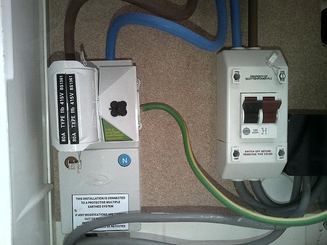

PME labelled supply, 80 amp fuse, isolator fitted
Henly blocks with one set of tails to the CU and a 10mm, 3c SWA also connected. SWA not glanded, just open, with one 10mm core taped g/y, end stripped and in mid air. No separate isolation or protection and a definite lack of room.

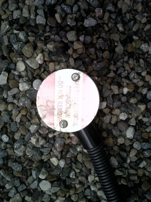

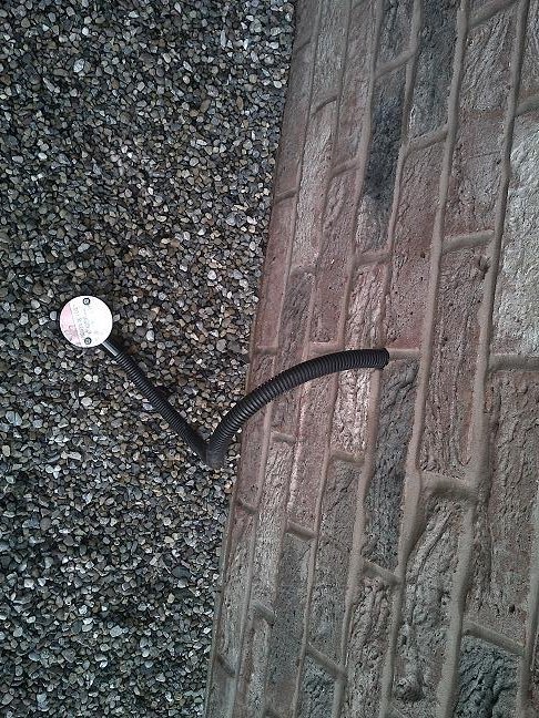

The 10mm core taped g/y was connected to the earth bar with another 10mm off to a rod, in mucho crapo cheap plastic flexible conduit to a stop end plastic conduit box in the ground.

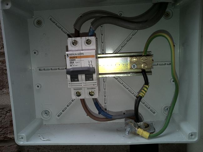

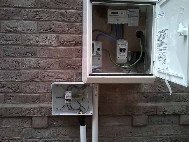

Well...as I feared, if not worse. He's been back to rectify.

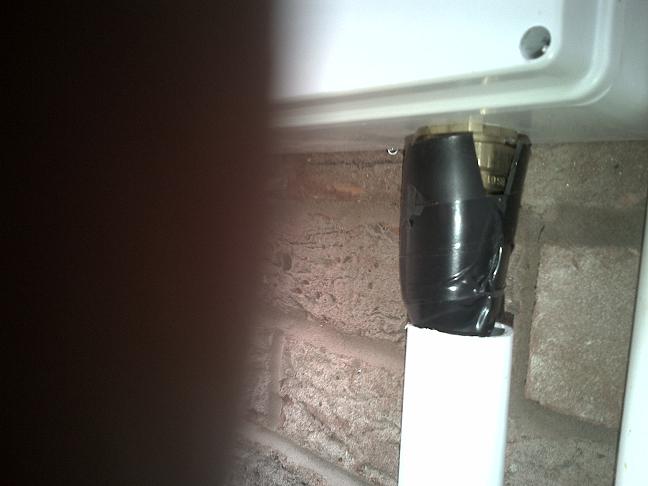

9''x6''x3'' plastic adaptable box fitted below the meter cupboard, at all angles to the wall resulting in the lid not mounting properly...so much for weatherproof.
Din rail and 60 amp dp switch and earth block inside. Swa glanded, internal banjo with 6mm roofing bolt and square nut. Earth cable to block with 3rd core earth. Shroud forgotten, slitted and black taped.
Earth loop at incommer 0.17ohm, at adaptable box about a foot away 72 ohm.
Still no sign of an RCD.
Shame I can't get photos up, phone problem.
The owner isn't best pleased and said the spark certainly wasn't a youngster. He wants me to rectify things. I don't think he wants to upset the builder for some reason, maybe a deal on the property, I don't know.
I'll get the test cert tomorrow get some details of supplies, test results, address, contact and NIC nos, etc and decide what to do thereafter.
