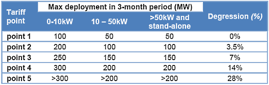

Was just reading the email sent over from REAL, in it they talk about the digressions etc but oddly they refer to a small system between 0-10kw
Is it 16p now for system between 0-10kw, feel lost now with all the changes.
The Government's consultation response also set out the cost reduction mechanism that will govern the way Feed-in Tariff rates can be changed in the future.• tariff rate changes are scheduled to take place every 3 months - January, April, July and October each year;
• the tariff rate changes will be determined by the volume of deployment in the specified 3-month period;
• the tariff rate changes will be announced 1 month following the period in question and implemented 2 months later;
• if the threshold is breached a tariff rate reduction (from 3.5%-28%, subject to deployment) will be announced at the end of the following month, and come into effect two months later;
• if the deployment trigger is not reached, then no tariff rate reduction will take place;
• two successive quarters without a tariff rate reduction will be followed by a guaranteed tariff rate reduction of minimum 3.5% in the third quarter.
• there are three different degression bands
domestic (0 - 10kWp)
 small commercial (10 – 50kWp)
 large commercial (over 50kWp and stand-alone).
(The tariff rate degression in each band is not linked to the deployment rates in the other bands.)

I think that the degression rates for both the 0-4 and 4-10 kW bands is based on the total installed across both bands.
ie if 75MW of 0-4kW installed + 75MW of 4-10kw installed = total of 150MW for the purposes of determining whether the degression for both bands will be set at 0%, 3.5%, 7%, 14% or the industry killing 28% maximum quarterly degression.
I trust this is clear as mud?
Gavin A
I could of course be wrong about this, as frankly I'm getting a bit bamboozled with the sheer volume of changes to absolutely everything that's going on at the minute.

You're right, Gavin. The degression bands are 0-10, 10-50 and over 50 kW. And it looks like just over 100 kW (probably around 120-130 kW) will be installed in the current quarter in the 0-10 kW band which will mean a 3.5% drop in tariff from 1st November.

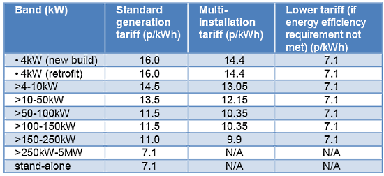

I know the 1-4kW is going to be 16p but anything above that now I'm lost
T
TedM
  • Thread Starter Thread Starter
  • #8
Rates from 1st August to 31st October - all now on a 20 year term:
And export will be 4.5p.

Makes the argument for going over 4kwp on big roofs easier with the new rates. That could be interesting in the domestic and small business market.
Yes, I agree. the rate on 4-10kW looks almost generous in comparison!
