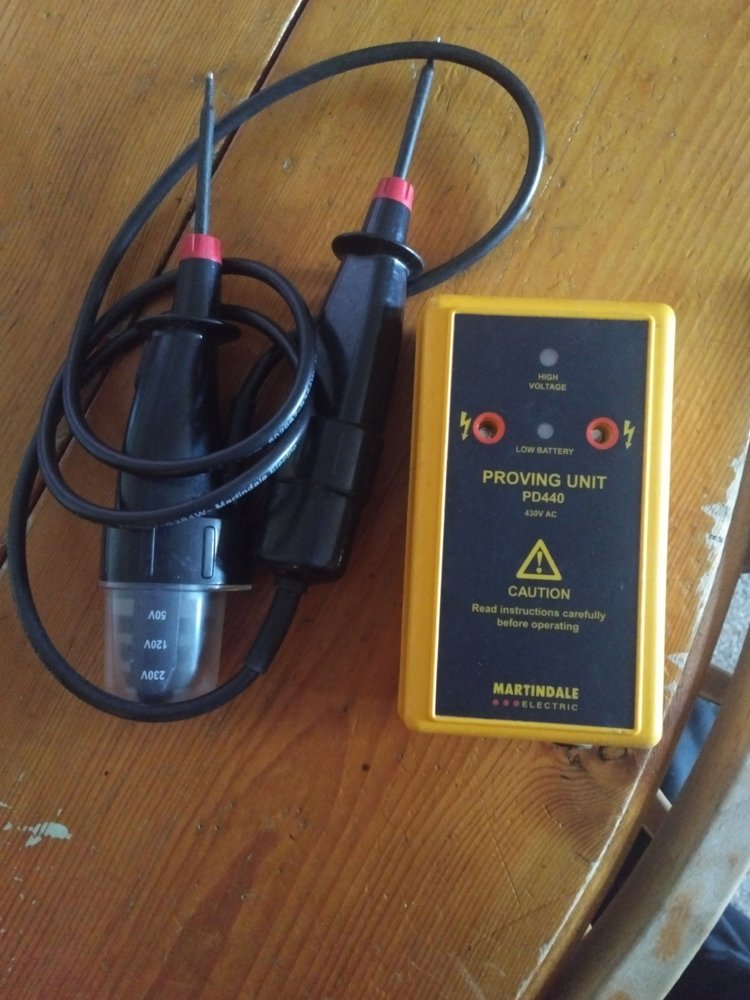

You can't really go wrong with them they are simple and don't lie or go into self test when trying to prove things are dead.
Always keep mine close!
You can pick them up for next to no money mine came with the proving unit as well for ÂŁ30.
Saying that you can't really put a price on your own life!

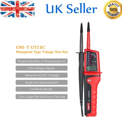

my drummond is the cheapo version. a torch bulb in the handle with a neon in case the bulb is duff. i had a TS1000, didn't like it. current clamp readings 20% out and the ohms readings were a joke. sold it on. rely mainly on my fairy light fluke T3.also have a ÂŁ25 chinese VI that has a LCD readout. each to his own, i say.
this is the one i bought as a back-up when i left my T3 at a customer's premises 40 miles away. still waiting for him topostit back to me.
