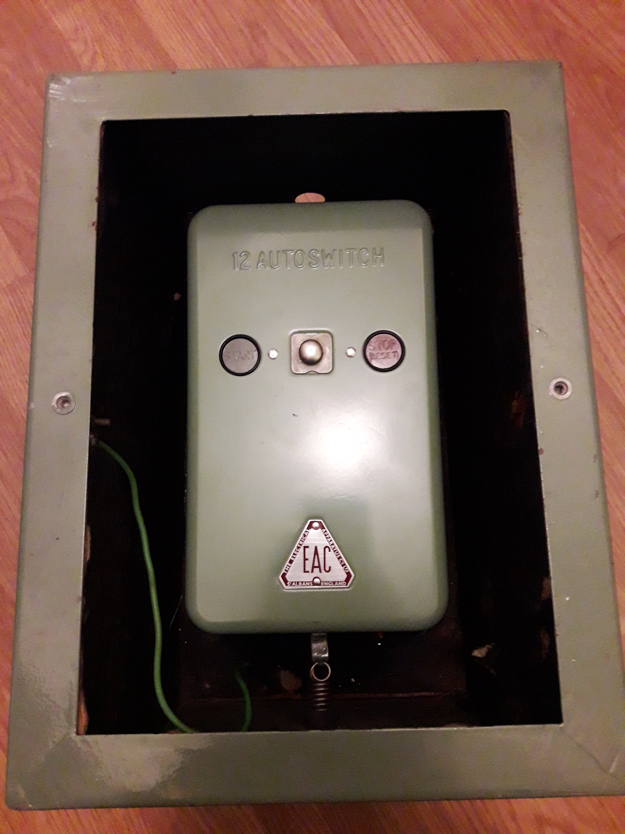

DC contactors for reasons unknown to me are much quieter. They seem to pull in softer. Well, the Schneider ones do anyhow.
DC contactors have always been quieter and better mechanically - they just pull in and stay in. An AC contactor effectively pulls in and lets go every half-cycle of the mains, i.e. 100 times per second. There is a tendency to chatter as the contacts close and vibration all the time the coil is energised. To minimise the effect and prevent the magnetic force falling to zero each time, part of the pole face of the laminated steel core has a copper shading ring that shifts the phase of the magnetic flux in that part, so that some part of the core is always attracting the armature.
Or you could do what some organ blower makers did with their starters. So that there was no audible clunk in the middle of the sermon when the organist started the blower for the next hymn, the whole starter was suspended on springs inside a hush box lined with rockwool. They often used rectified coil supplies too.
