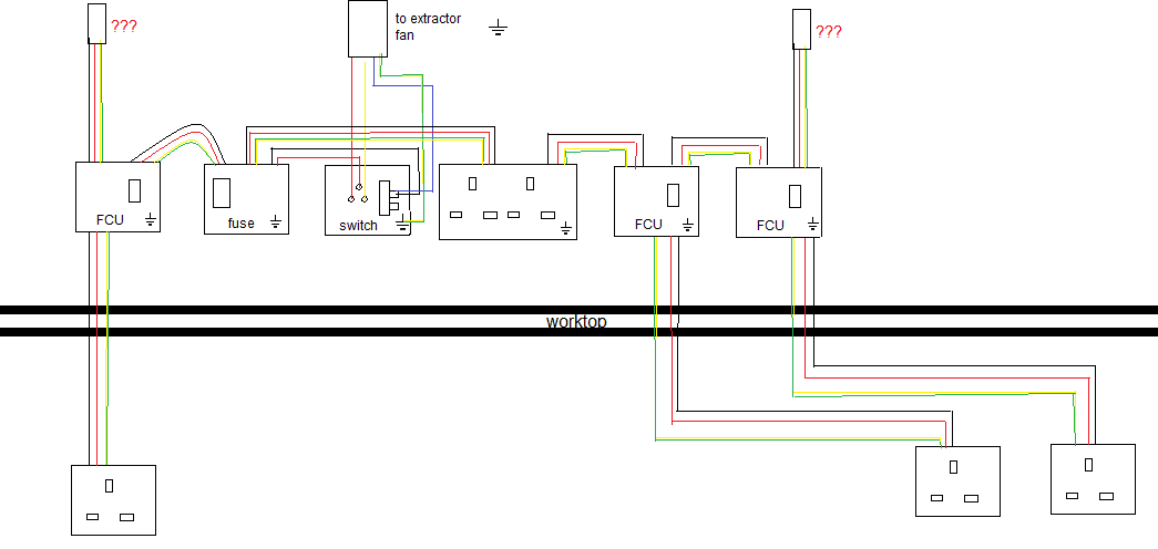

Im doing my kitchen and have a question regarding the arrangement of some wall mounted fused switches and in cupboard mounted sockets
On the wall I’ve got a couple of switched FCU’s.
Each of these FCU’s are linked to 2 non switched single sockets that are inside the cupboards.
The wall mounted FCU’s are mounted in between a couple of wall mounted plug sockets.
In an effort to have fewer wall mounted gear visible I want to do the following:
-Remove the FCU’s
-Join the cables going to the under cabinet switches using a suitable MF connector
-Replace the under cabinet sockets with switched versions
-Blank off the area where the FCU’s were with a flush steel plate or something similar screwed into the back box
-Tile over.
I think creating the cable joints seems fairly straight forward provided i use suitable MF connection methods (i was thinking of using wago 773's)
What im unsure about is the fact that tiling over means there would be a couple of sets concealed live cabling behind the tiles.
Although the steel plate would provide some degree of protection, im unsure of the correct and accepted method of going about this.
Im aware that I could fit surface mounted blank plates but id like to have as few sockets/switches and blank plates showing as possible.
Can anyone provide some advice on how to do this for a DIY'er?

If you remove the SFCUs and replace with connector blocks you will have two unfused spurs going to two switched sockets hidden in the cupboards.
Firstly what was/is connected in the cupboards, secondly do the appliances need access to isolation and/or emergency switching?
Standard common sense switching will always have local and accessible isolation and fusing.

Thanks for the posts all, reckon ill get a spark in to do it correctly based on your advice.
On another note, im assuming the cabling from the FCU to the sockets is chased into the wall and runs down behind the kitchen work top.
If that is the case would it be likely that the worktop and base units would have to be removed in order to make the changes im looking for?

I think the previous owners had several integrated appliances that are no longer there and not likely to be replaced. Thats why i wanted to do away with some of the unused wall switches and keep the sockets in the base units just in case.
Would the fuse fitted into the appliance plugs not suffice in this situation? (each fcu feeds a single socket)
most of the sockets are unused, one of them is for a dishwasher. I think the previous owner had some integrated appliances in the units. I wont be replacing them due to the new kitchen layout.
I figured the only time id need to isolate is when im pulling the appliance out so id just do that at the socket anyway.
In the case of an emergency my first thought would have been to isolate at the CU which for me is close by instead of going near the appliance if it catches fire or something like that.
If an appliance is intergrated and the socket is behind this then a sfcu to isolate it would be required, a switched socket in the adjacent cupboard would be a good alternative. I increasingly get asked about having no sfcu at worktop height and dont have a problem. A bit more thought and talking to customer during 1st fix goes a long way to getting the desired finish.
what are your thoughts on a cooker isolator being in the adjacent cupboard?
fortunately i have this arrangement for the two FCU's that i want to remove...the sockets are mounted under the unit which houses the sink/plumbing etc. The dishwasher is in the adjacent unit and the other socket is unused.
Im not sure if its good practice having sockets near stuff that could potentially leak but that's a story for another thread!
I already have a cooker isolator but thats fitted on its own, located on a different wall so not a problem
youmay well find that the FCUs are fed from adjacent sockets, so ant redundant ones could have their supply dissed at relevant socket. doing it that way would not compromise cables in prescribed zones not being easily identified by in-line accessories.
