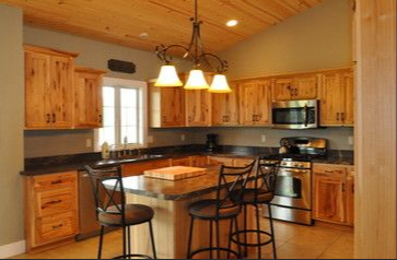

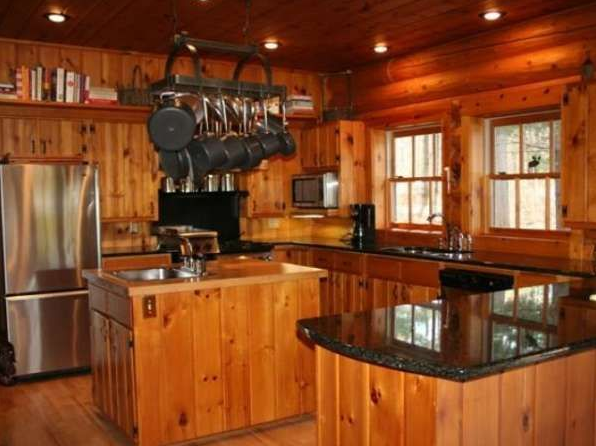

Maybe show the client something like this, or this.
See if they go for it?
Maybe show the client something like this. See if they go for it?
that would seriusly involve demolition of walls. is a sparks is uncomfortable with this, might need to call in a builder.1596120533405.png arrgh.i swore on the forum and no redress.

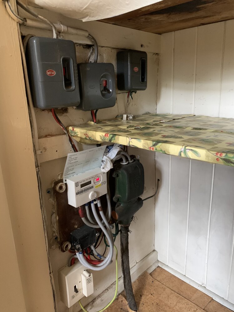

You think the washing machine is bad, have a look at this...
Not far off turning it into a sauna ;)
Just need to add the main aspect - the electric cooker and we’re ready to go :p
They’re on a proper budget, I would love to do a job like this
[automerge]1596194356[/automerge]
that would seriusly involve demolition of walls. is a sparks is uncomfortable with this, might need to call in a builder.View attachment 59808 arrgh.i swore on the forum and no redress.
I will demolish the walls with my hammer and bolster when I chase out ;)
