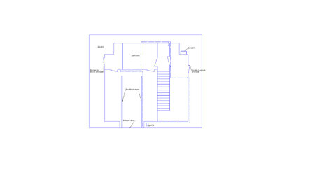

Good evening All. Maintenance electrician here moving into domestic installations.
What I'm still struggling with is the ring finals routing, especially in loft conversions.
I am wiring one at the moment. Can you please have a look at the diagram below. Apologies it's very basic and rooms are out of proportion but should hopefully make sense.
I have marked the socket-outlets with "stars", I initially wanted to run the ring all the way around the house in the eaves (very large on left and right side of the building and narrow on the longer edges).
However, there is a balcony door and I would either have to run the cable in the eave overhung or drill through structural beam. I've decided to wire to the last socket and go back to the origin across the room.
I also run the cable across the smaller room to bypass boiler and pipes. Cable will not be burried in the insulation. Any advise on how you would tackle this would be greatly appreciated.
Also, the owner asked me to re-wire the bottom floor. He would like to fit modern ligts without ceiling rose. It's an old building with rendered walls and I don't want to do loops in the switches to minimize mess when chasing walls. Can I use MF Wago boxes and do all the terminations in the ceiling?

Without actually seeing the property its hard to give definitive answers.
You can run the cables anywhere you want as long as they are within zones, are not in locations where there is a risk of damage, are not adjacent to other services, and don’t compromise the integrity of the building.
The routing in the diagram seems fine To me.
advice on how to do this. I’m afraid you just have to lift the floor boards and do it. If you have to drill through joists to achieve this, make sure the holes are in the correct locations and sizes and distances.
as for the light connections in wago junction boxes. I would not do this. If you do, make sure the j/bs are accessible.
if your customer wants work done then he has to accept there will be damage to the fabric of the building in order to run cables.

How would you feel about large junction boxes fitted in the eaves and running all cables to lights and switches from there? This would be easily accessible for inspections.
If it's a single switch and one light in the centre of the room type of property, then it's rather pointless, but for anything more complex, involving multi gang switches and multiple lights in a room, this has been my preferred way of wiring lighting circuits for several years, placing the box in an easily accessible position.
Write its function onto every cable, in pen, just outside of the large junction box, and identify which MCB feeds it on the lid of the box in permanent marker.
may not be MF then
Tell you the truth, I feel that the thousands, of Ashley J401, 301, 201's that I've installed, PROPERLY AND WELL, over decades, are perfectly suitable for installation as 'maintenance free'.
The reason for the whole MF 'thing' is because of stupid, sub standard, so called electricians OR diy experts ferking up the installation of them.
