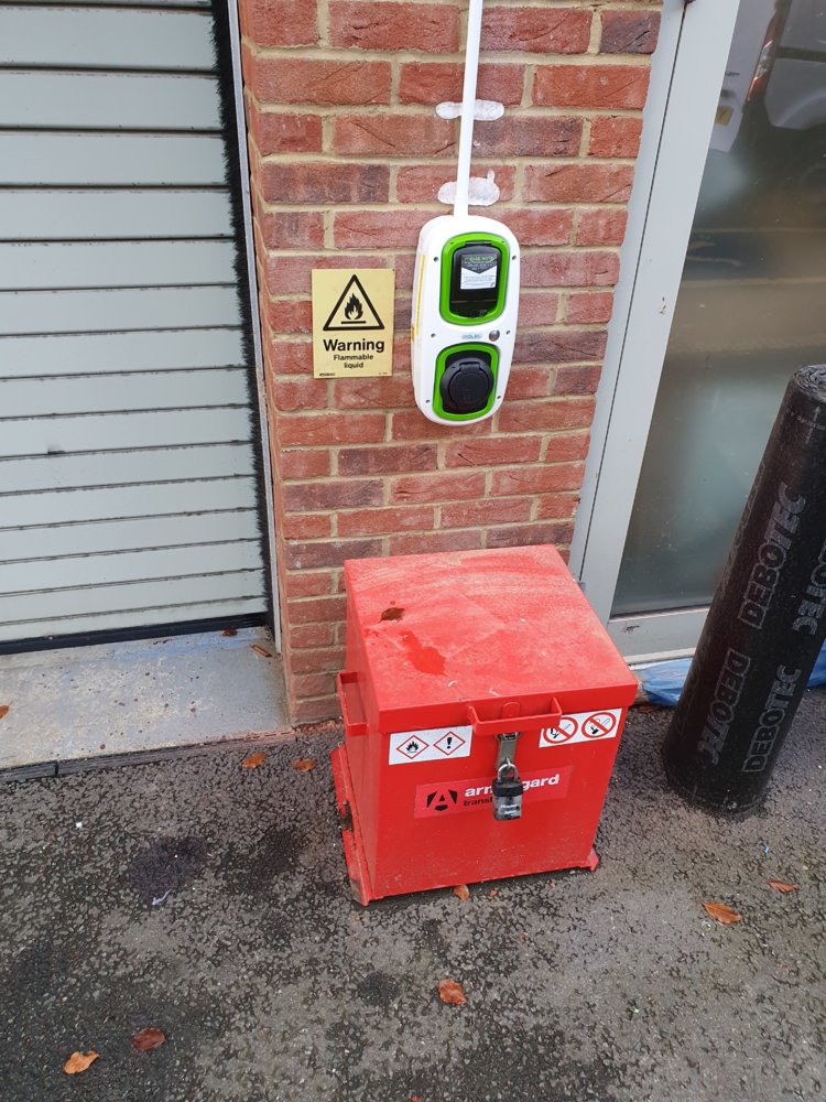

I work as a maintenance engineer at a school and recently we had an outside contractor come in and fit an external Rolec EV unit to the outside of our workshop under the grant scheme.
I don't know much about the installation of these units but I did do part P several years ago so I have some electrical understanding. Consequently I do have some concerns about the installation which may be an issue or maybe more likely just my lack of knowledge!
The EV unit has the internal RCD for the AC supply, and the seperate RCD module for any DC injected back into the circuit. It has been installed with an internal isolator, meter and comms box which all seems fine.
However,
1) The contractors installed a new circuit in our DB for the EV supply but there is no test certificate to show results.
2) The unit is installed in our yard where we store gas cylinders and fuel. The charging unit has been installed directly above a metal storage unit that contains gerry cans of petrol. Gas cylinders are housed in a cage about 2 meters away.
3) The earth from the EV unit has been connected to the building's steel rainwater downpipe which goes under the ground but I've no idea how deep the pipe goes.
Are these issues cause for concern?
I'd appreciate your thoughts.
Many thanks.

Regarding the earthing, it's been connected to the Lightning Protection which isn't ideal but if it's working properly it'll have an overall resistance to earth of less than 10 ohms. I presume you do have the LP system maintained?

1 Yes an electrical installation certificate should have been completed and issued to the person ordering the work.
2 personally I think that is a daft place to install it and if I had been doing the job would definately have questioned the location. Whilst it should be absolutely fine and is unlikely to be a problem I would err on the side of caution.
3 it's not right, the lightning protection system should be bonded to the Electrical Installation at the main earth terminal and that bond should be connected underground at one of the earth rods. The odd connection they have made could cause a lightning strike to partially divert via the EV charger circuit.
If the LPS is correctly bonded then it will act as a very good earth electrode for the installation sufficient to allow even a PME earth to be used for the charger.
I suspect the installers take a one size fits all, monkey see - monkey do, approach to these installations without applying any thought to the job.
I don't know the ins and outs of LPS which are essentially a stand alone safety system aside from the recent requirement for it to have a main protective bond to reduce pass over in the event of a fault, the chances of the original specification to allow it to be used for another purpose are all but zero.

I do this all day every day and I wouldn't say anything about it - if I saw this during an inspection I'd just assume it was a bond to the electrical earth as would my colleagues
That could well be a natural assumption, do you never verify this. Would this not be deemed an important part of the inspection??
But it appears to be undersized for the size of the installation and its above ground when it should be below ground level at an earth rod termination.
