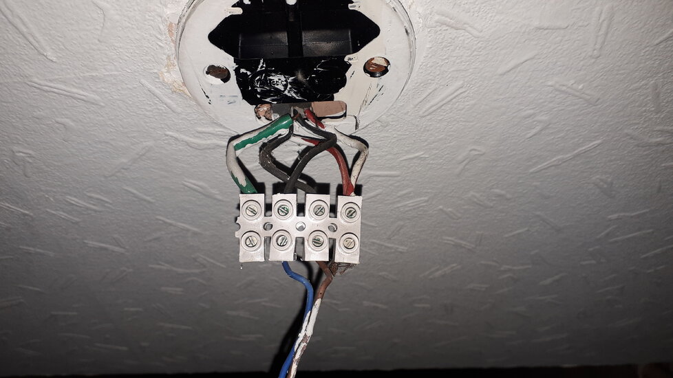

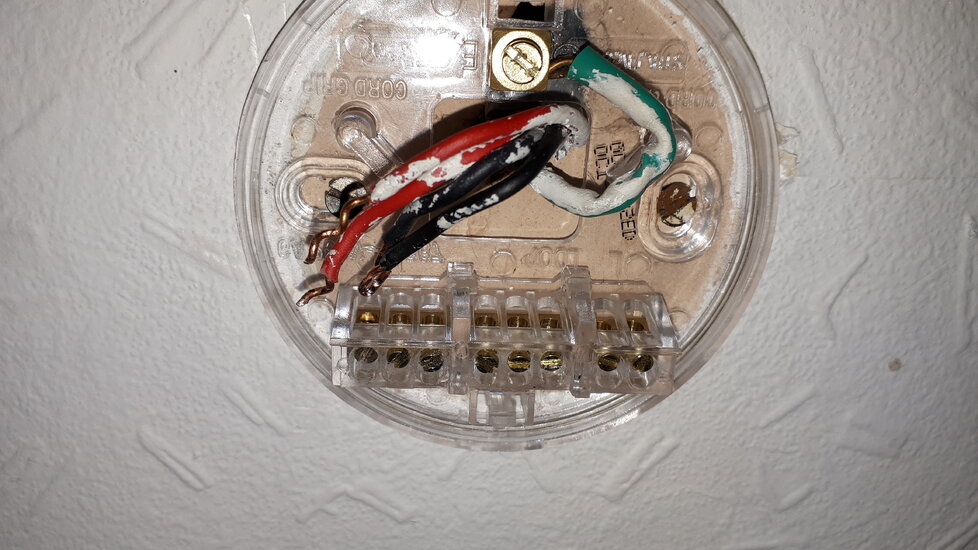

I wonder if anyone could help me with this. I want to replace an old light fitting which was a bit cracked and broken. Images of old wiring below, 528 attached. Now I want to wire it up with to a new style rose images 236, 114.
When I look at the wiring diagram for the new set up of 8 connections I seem to be missing two wires. (I have 2 live 2 neutral in the diagram and 2 for the lamp) If we call the far right connection 1 and the far left connection 8 so that each connection has a number, which wires should go into which number/connection. Any help really appreciated.
John Rose Wiring (old wiring to new wiring) 20190218_141528 - EletriciansForums.net Rose Wiring (old wiring to new wiring) 20190219_170236 - EletriciansForums.net Rose Wiring (old wiring to new wiring) 20190219_170114 - EletriciansForums.net

Put the two reds in the middle block.
Put one black in each of the other blocks.
Connect your light wiring (blue and brown) one to each of the blocks with the black wires.
You should end up with two reds in the middle block, a black and a blue in another block and a black and a brown in the last block.
If your fitting has an earth wire (Green and Yellow), connect that to the terminal with the green wire.
and get rid of those pigtail ends. what sausage twists solid conductors? (not you ,OP, whoever installed it).
Spin’s got it sussed
The two reds are permanent live.
One of the blacks is a switched live, the other is a neutral.
In a perfect world, one of those blacks would have a bit or red sleeving or tape to say it’s a live.
If it’s a bog standard pendant you’re fitting, it doesn’t really matter... a black to the brown of the flex, the other to the blue.
The purists among us would prefer the switch live to brown and neutral to blue, but you would need test equipment to figure that one out.
As long as the two reds are joined together and to nothing else, it’ll work fine.
You will need to find out which one of the blacks becomes live when the light switch is on this is the one that the brown goes with. you have a 50/50 chance of it being right.

Spinlondon, you are the man, thank you very much, it worked first go.
