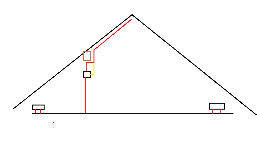

Hi
I am fitting conduit in my attic room ready for when i get it rewired so i can plaster up and have a finished room for the time being. I won't be running any wire.
I have 2 x 20mm going up to a 35mm deep knockout where a dimmer switch will be located for a 3-way switch rig. Out of the top runs 20mm conduit up the wall and then along the ceiling line (it follows safe zone rules) up to the ridge.
What i am unsure of is if i can use this same conduit to run the cable through for the smokes, the reason is the cable for the smokes will run through the knockout (and not terminte/join in it). My concerns are whether that is fine for part p and if so is a 35mm box deep enough for the cable and a dimmer? I would just run conduit up for the smoke detector, but there are no direct/easy safe zones for the vertical run without going through the rafters (which are boarded already), which is why i am hoping it can be passed through the knockout to meet the 'horizontal or vertical from a fitting' criterea.
An electrician will be connecting and feeding the wire, which is why i am using 20mm round, i am just fitting the conduit and doing the channels so i can get the attic room plastered and save some money. I need a liveable room for the time being as it is a full refurb and wont be ready for the rewire until summer, so i cant employ anyone sooner (so no advice) and i cant put off the plastering (living in a bare brick house is depressing).
I am also wandering if i can find a simpler way to route the conduit from the top of the switch to the ceiling, a way that will be less twisty (assuming it might be tricky to feed the cable now i want smokes AND a light running through it). I used 90 degree bends to get around the purlin and was going to feed a line in it so the leccy could pull the cable through but it might be a PITA. I am unsure if i can run vertical from the side exit on the knockout (shown in yellow on the pic). I don't really want to move the knockout box, it is put in the best place to reach it from where the bed will be.

I have found an electrician that is fine with me doing the channels and conduit (i have experience labouring for electricians) so he can feed the wires but it is up to me to me to make sure i get the conduit right and i dont want to be having to relocate anything or run extra conduit in after i plaster.

Simple answer is to get the sparky to run the cables before you plaster. Thats how the vast majority of us do it!

Indeed it is the simple answer, but not the possible one. Like i say i just aint willing to spend another 6+ months in a bare brick shell before i can get the electrician in. The novelty has passed i need a decent room. I don't have fat wads of cash kicking around, plastering is cheap and i can do that myself so it won't delay getting the wiring, but i cant bring it forward :)
I appreciate any help, but tbh i asked this on another forum and all i got was this response and no actual advice. I kinda already know the correct order, this aint my first 'refurb party', but the situation is what it is and i need a room for now. Obviously it would be good if i could avoid having to knock more chases in down the line if the answer can be given but it has to be this order. Even if i have to smash holes left right and center in 6 months it is getting plastered. :)
