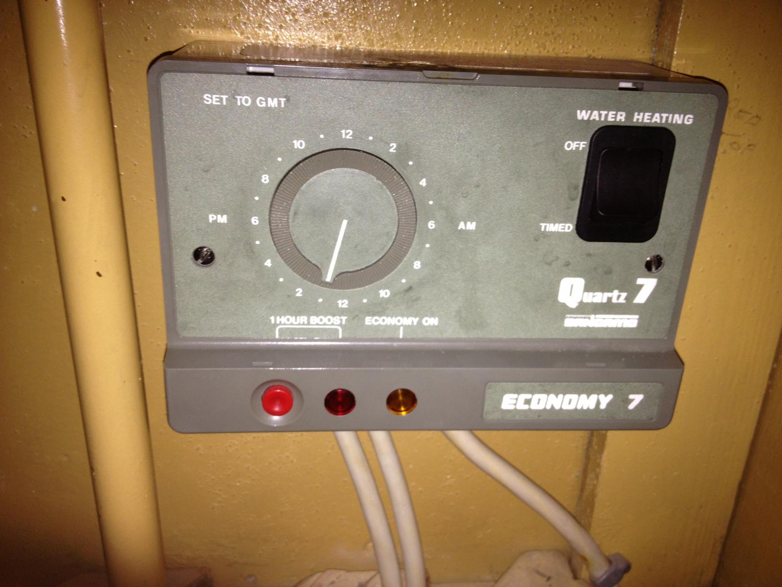

Evening all,
Went to a job tonight and had a look at one of these economy 7!timers. Never seen anything like it.
Then 2 cable came out of the timer an went into ONE immersion element. Opened the element and found it had two stats
Ones on peak (used during the day as a boost option) ones off peak and its usually timed for when the cheap elec tarriff comes on in the night
you can buy replacement timer units like this one if you need it TLC are good
