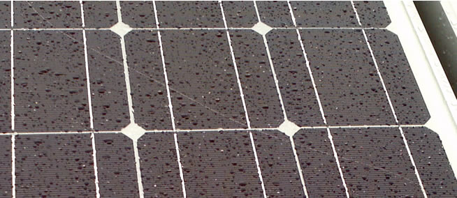

Hi,
Just had 16 PV panels fitted last week and all seemed to go well, but have just noticed a few of the panels have quite long scratches (see images) on the top of them (scaffolding is still up, so I went up for a look)! I can really only see the bottom row of panels and 3 out of these 8 are scratched. Is this likely to effect the efficiency of the panels and do you think its reasonable to expect the company to replace them?
thanks in advance for any help.
David
It's not ideal. Imagine if you spent £10k on a new car and it turned up like this. It might drive ok but would you be a happy bunny? I'd be withholding final payment until sorted although with the FiT rush, you may find your hands are tied. Better to act now otherwise the scaffolding will disappear and cost/hassle will increase.
Thanks for replying. Unfortunately, the final payment was made last week after installation so I could get the MCS Cert and get everything sent off for the FIT application. I only went up to have a look today out of curiosity and that's when I noticed the scratches. I will get in touch with the company and see what they have to say.
Does anyone know if this will any effect on power output?
Power output initially wouldn't be much affected but I expect the scratched panel will degrade quicker and the anti-reflective coating may well be compromised. Are the scratches definitely on the outside of the glass? Can you feel them when you run your fingernail across them?

Would you be happy taking delivery of any other item of 'brand new' equipment with dirty great scratches on it......I certainly wouldn't.
it will compromise the performance of the panels and now the coating has been compromised water and frost will get in, causing it to lift even more. degredation of the panels will be significantly accelerated.
In ten years time the condition and performance of your panels will be significantly less than you would expect (maybe sooner)
it just isn't acceptable.
I really do not agree that the scratches can in any way affect the panel's durability. All MCS accredited panels are encapsulated in very thick glass and a scratch isn't going to make water go anywhere near the PV cells.
What may happen however is that the scratches may cause some very slight shading onto some cells, and even if only a couple of cells experience some shading the output loss may not be insignificant as cells are connected in series and so are the panels..,
I would suggest you ask for a replacement. If the modules were already scratched when the installer received them, the module warranty should cover that.
does shading afect the performance of a panel, yes, do scratches inpair the performance of a panel, yes, in exactly the same way. It's not to do with the cells, it's to do with the transmittence of light. Solar panels (good ones anyway!)have hydrophobic and antireflection coatings on them to improve the transmittence of light (by about 8%) and the panels ability to self clean. If you damage this coating water can get underneith. this then causes lifting of the rest of the coating, causing a delaminating effect over the surface of the panel. This forms crazing of the coating which will block the light transmittence and will become more and more extensive as more time passes. The effect accelerates with time as the affected surface area gets larger. superficial scratches that don't penetrate the coating you'll get away with, but deeper ones are a problem. by deep bear in mind the coating is nanometers thick (thats 1.0x10 to the power of minus 9)
but then what do I know, I've only got a degree in optics!
coincidently my mate rang me just after I posted so I asked him. He confirmed the above.
He's a doctor of physics specialising in thin films technology, probably one of the top 3 specialists in his field in the world so I think I'll take notice of what he says!

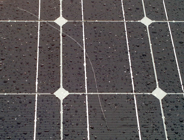

I include a photo of one of my nine scratched panels
Sent the following email (and photo of a scratched panel) to REC headquarters in Norway yesterday (no UK office):
“Please could you advise me on whether an 'alloy scratch' on my solar panel (caused by the aluminium frame of one panel being slid over the glass of another panel) will have any of the following adverse effects:
- void the 25 year output warranty
- damage the integrity of the anti-reflective coating
- be likely to cause the panel to degrade/lose output quicker than an unscratched panel
Please could you also confirm that indeed the anti-reflective coating is on the exposed side of the glass.”
A reply came back today:
“Dear Sir,
Thanks for contacting us.
No, this small scratch will not affect your product warranty.
Moreover, we find it very unlikely that this scratch will cause the module to degrade over time.
So nothing to worry about.
Regards,
Christian Heinlein”
Christian Heinlein Ph.D. | Senior Product Manager | REC Solar AS
Mobile: +47 928 28 546| Fax: +47 67 57 44 99
www.recgroup.com
Are they actually scratches? It depends what the anti-reflection coat is (some are quite hard), but glass is a lot harder than aluminium and you can't usually scratch it with aluminium. However, you can 'draw' on glass with aluminium and leave a thin layer of aluminium on the glass. It's a common problem where aluminium pots and pans are used on glass hobs. Usually solution is to leave some dilute bleach on the mark for a hour or so (which corrodes the aluminium) then rub off - not sure I'd do this on a panel though unless knew that the bleach wouldn't attack the AR coat and it would need keeping off the aluminium panel frame.
it will attack the AR coat. best bet might be spectacle cleaner!!
It is possible to scratch the coating not the glass. the coatings aren't as hard as the glass.
Certainly on my panels the 'scratches' are indeed a thin layer of aluminium.
The installer wanted to clean these off using a stanley blade but I pointed out on a downloaded REC maintenance sheet that such things were on the DO NOT list.
If the scratches are as the Norwegien REC man says, not likely to degrade the integrity of the panel, then perhpas they are best left.
It is indeed like having a scratch on a new car, it shouldn't be there.
