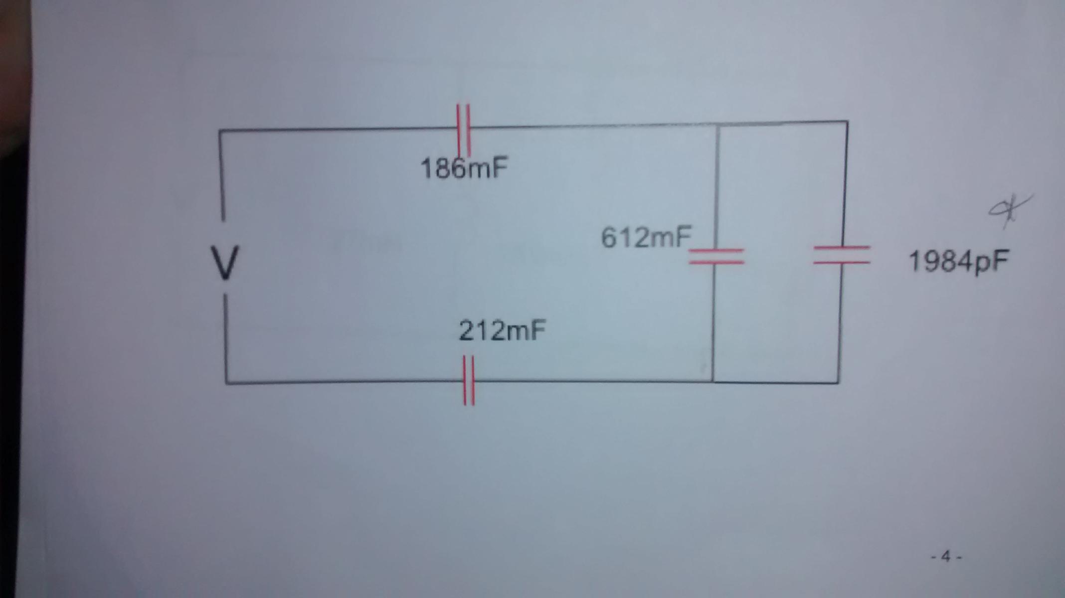

Hi all
I am carrying out my assignment and a little stuck on this i have to work out the
Total inductance
and total capacitance
now I'm aware of the formulas for series and parallel inductors and capacitors but as you can see from the picture i have a series/parallel combination and I'm unsure how to integrate this into the total inductance and capacitance for the two following diagrams shown in the photos.

I am not asking for the specific answer only the equation for combination of a parallel inductor for example in the one instance in a series circuit from my understanding i would calculate the equivalent resistance with 1/(1/4+1/0.21) and integrate that into the series equation which is simply the sum all of individuals inductors added together.

Just to clarify i am not a practicing electrician this is for my HNC in building services engineering i am an air conditioning & refrigeration engineer. I have done all my equations so yes i have done my own research and put a lot of effort into it but i was under the impression this was an advice forum, and would like to be thorough and get advice from electricians with first hand experience in this. I can look up equations and formulas no problem with google, read countless articles but i find some people can put it into a better context never the less i have uploaded my answers and equations for total inductance and energy stored within the circuit.

A, I get the same result for the inductor circuit. Take care with the 'precision' of your answer; it shouldn't exceed that of the precision of the information provided in the question ... ie 383 mH rather that 382.5.
A, I get the same result for the inductor circuit. Take care with the 'precision' of your answer; it shouldn't exceed that of the precision of the information provided in the question ... ie 383 mH rather that 382.5.[/QUOTE]
Thanks kayak i did wonder if i should drop it out.
