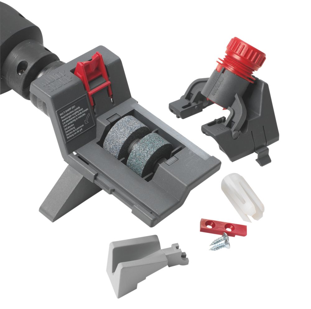

I can't find a previous thread on this topic, so here goes.
There is one sort of house-brick that I dread encountering in my area - they are known as Ruabon Reds and they are extremely hard and unforgiving. After working a lot on two houses with these bricks the same week I've blunted almost every SDS drill bit I possessed including spares, and wore out a further brand new Bosch set. I thought rather than shelling out for yet another new set it was worth a try reviving them, so I was looking at getting either a bench grinder and having a go free-hand, or a bespoke sharpening machine and I noticed this cheap product at Screwfix:
https://www.NoLinkingToThis/p/multi-sharp-drill-bit-sharpener/8522H
I thought it was worth a gamble for £20. The instructions are fairly clear, with specific instructions for SDS bits. I practised a bit on some drill bits that I hadn't used much and established that I was indeed improving them, and then set about the truly knackered set of 5.5, 6 and 7 mm bits.
In short, it works a treat. One older bit was completely rounded with no discernible edge at all and it even managed to revive that after some prolonged effort- I tried it out today on a job and it was like a new bit.
Here's the product video:
So in summary it's given the bits another lease of life and will undoubtedly pay for itself.
It isn't a super-strong gadget so will need careful handling, but it's also only £20.
I'm interested if anyone else has used one over a long period, or indeed uses any other methods to re-sharpen things.

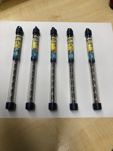

I have come across some very hard bricks round our way especially in the old railway built houses!
Many a burnt out or mushroom shaped drill bit beyond grinding.

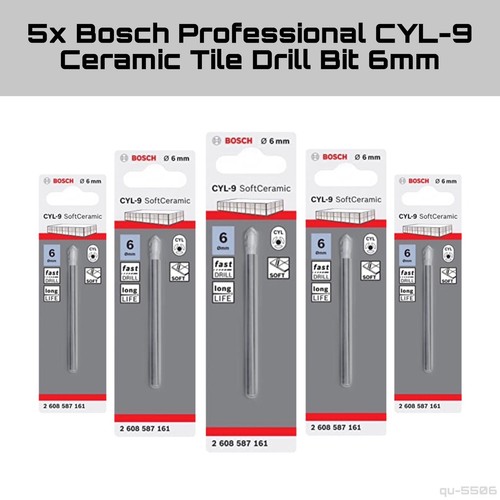

Have found some of the Non-SDS drill bits like the Irwin and Bosch multiconstruction ones really good for these type of very hard bricks and even some of the Bosch tile bits are good for extremely hard to drill surfaces.
These,
And these,
https://www.NoLinkingToThis/p/bosch...kEOkUDqvdj1WWloeWPBoCm3cQAvD_BwE&gclsrc=aw.ds
And finally these.
