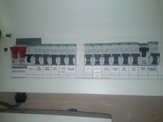

So a bit of fun as it is a bit quiet. This is mine been there since I moved in and has all the required notices and selected additional protection. The first Proteus one wins the wooden spoon.
Show us your consumer unit. 20191012_182353 - EletriciansForums.net
Is it caked in notices :)
[automerge]1570902970[/automerge]
How come some are the compact rcbos.

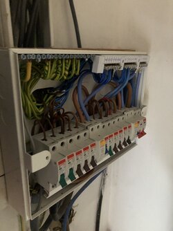

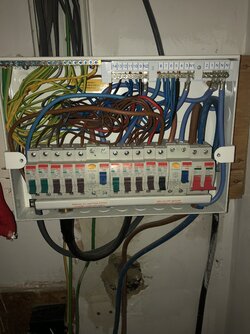

Had a BG when I moved in:
Show us your consumer unit. IMG_2057.JPG - EletriciansForums.net

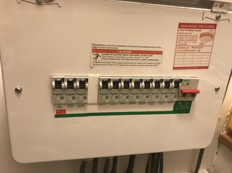

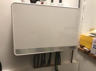

Got off my bum a couple of months ago and replaced with Wylex full RCBO ready for getting our bathroom done so I can fit an electric shower.
Show us your consumer unit. IMG_2185.JPG - EletriciansForums.net
