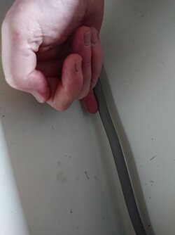

A local firm fitted a new bathroom and installed a shower. They replaced the wire to the fuse box and added the unit to the old box as shown in the photo. There was a smell when I went in to the cupboard, and the B32 unit is quite hot to touch, and the wire is warm. I'm planning to upgrade the box anyway and hope to avoid replacing the wire otherwise all my new tiles will have to be replaced. What did they do wrong? BTW the kitchen firm have vanished!! Thanks. DSC_0360.JPGDSC_0361.JPG

Thanks for replies.. It's a Mira Vie 9.5Kw. The cable is flat and there's no RCD...

There's no certification. The bathroom is directly above the cupboard so I'm guessing five or six meters assuming it wasn't rerouted but I can't see why they would have needed to. Should I open the shower and check or tighten the electrical connections. Switch mains off obviously...

At 24lV that will be drawing approx. 39 Amps, the MCB @32 Amps is hardly suitable and the cable looks from the picture you provided far to small, RCD protection is a must, how long ago was it fitted, what information is recorded on the certificate, does the Company that installed the Shower belong to any Professional body NICEIC as an example? call them back with your concerns

Wouldn’t recommend opening the shower unit mate unless you are competent and understand safe isolation procedures....as @Pete999 mentions above the 32mcb is undersized, but hard to see the cable size from the picture, and if there is no rcd protection there should be as they’ve run a new circuit to a special locatation, I’d contact the installers and take it from there

The reason for the OCPD heating is because it is working at its Max, as well as being to small, checking the tightness of the connections should be done by an Electrician, your options are call the Company back with your concerns, or shell out for an inspection by a qualified Electrician and send the company a copy, specifying that you intend to take this matter up with Trading Standards, see what reaction provokes.

Is there any writing on the cable signifying a size? ie 4 + 1.5 (which is what I think it is) or 6 + 2.5?
The larger number being the live conductors and the smaller being the cpc (earth wire)

If we can work out the size of the cable, then we can maybe advise changing the shower to something less powerful. Or replacing the cable, which is near impossible now if its tiled in.
The lack of RCD will be sorted when you upgrade the consumer unit, and please this needs done asap. In the meantime, using the shower as it is could damage the cable.

Brilliant.. Yes that's exactly their name.. Luckily I was planning to get that entire mains fuse box replaced anyway so I'm hoping that the wire will be adequate. It's a solid looking piece of cable as thick as my little finger and flat. The unit it attaches to is simply the wrong rating?

Thanks for all your replies. I can't see any writing on the cable but I guess if with the new box there is no heating it may be adequate cabling? I am ringing round electricians.. I will get back to you with the outcome!
