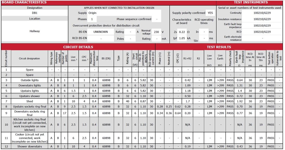

Please find attached the board characteristics test. This is just one page of 9 within the document so I can always look for something specific if required.
I was well out on the wires, only 6mm for the upstairs shower and 10mm for downstairs.

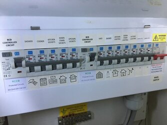

For any aficionados here is the board itself too.

that looks good to me. both those showers should be on 40A for the upstairs shower, as long as the cable is nowhere covered in insulation, and a 40A or even a 50A for the downstairs shower. simple job to get him back to swap out the MCBs.
as a side note, though, 32A MCBs will withstand the 4A t0 8A overcurrent for far loger than it takes to have a shower, so even as it is, it's safe. might get the occasional trip on the 9.5kW shower, but unlikely. the lifespan of the 32A MCBs may be shortened somewhat as they are running at their rated limits.

9.5kW is on the limit of 6mm cable. 10mm cable can happily supply 10.5kW. another thing to bear in mind is that the MCB only needs to protect the cable against short circuit faults. it does nort have to provide overload protection, as a shower is what is known as "a fixed load". so you may see installs where you'd think the MCB was over rated for the circit.
