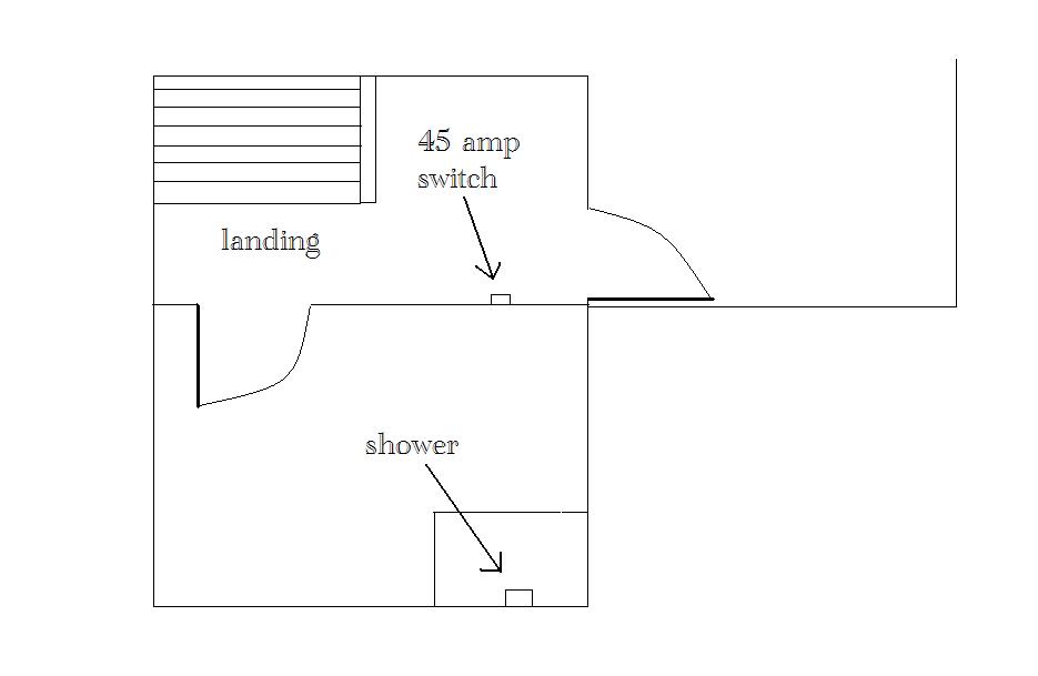

is this switch location ok , i will be wiring a shower soon but have no access to install a pull switch
hopefully you can understand my very poor drawing:eek:
thought so, never checked regs as i always fit outside (pers choice) but sure its 0.6m from bath for zone 2 and anywhere outside is ok...
