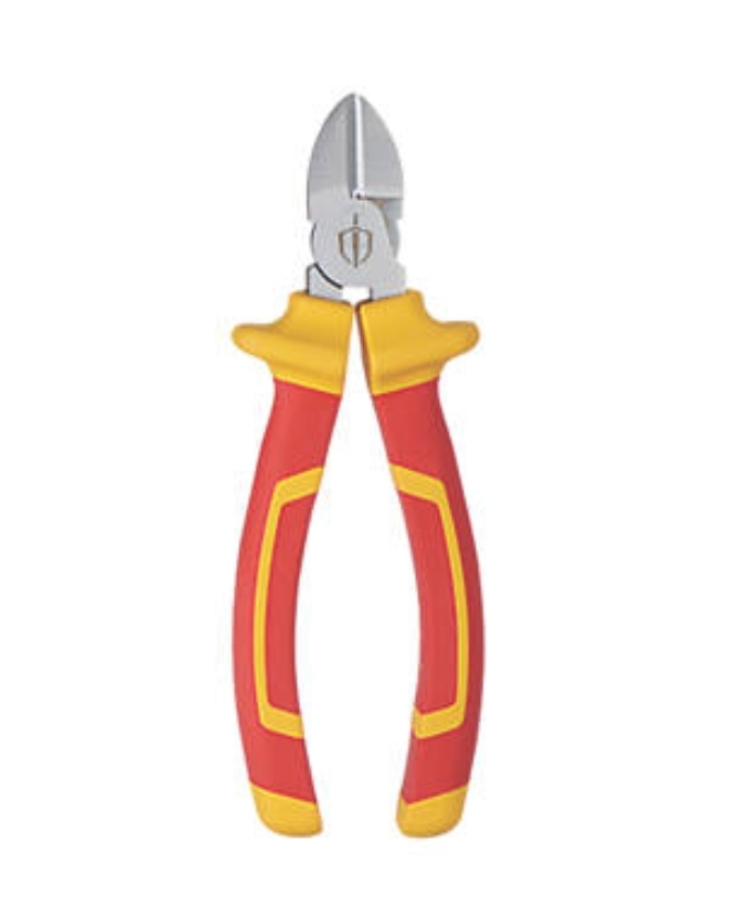

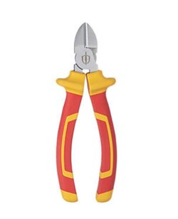

I'm just wondering what the difference is between these two tools below.
The cable cutters seem so much easier to strip cable with and to take off the pvc to expose the copper but they use the side cutters in college.
Might be a stupid question
those are for cutting giants toe nails and the others for cutting chickens feet lol.
the side cutters are for cutting cable down one end and cutting small cable e.g. 1.0 mm to 2.5 other are for tails and cables above 2.5.
Very different tools to me... although I have seen some sparks use the cable croppers (shear type ones) for everything, doing away with side cutters.
As Buzz said... I only use my croppers for big cables, side cutters are always on me though.
side cutters have a flat angled edge , croppers (cutters) have a much sharper finer edge.
croppers are good for flex , round cables and have the little notch in the end for stripping.
side cutters can be used for pulling nails , cutting down screws and will stand up to more abuse.
if you cut a m4 screw with croppers you have pretty much knackered them...

One is for large cables One isn't, the smaller pais sometimes have wire strippers incorporated
Two different types of tools but seen them used for the same thing!
Ive seen cable croppers smaller than side cutters so don't necessarily go along with the thought that croppers are for bigger cables but admittedly are easier for cropping meter tails and compressed/compacted conductors such as in some armoured cables.
Seen too many broken solid conductors from over zealous use of side cutters and shears for stripping cables.
Use CK auto strippers and remove the risk.
You can now by side cutters with a 1.5 & 2.5 notch in them to aid with stripping...
but I to like auto strippers as well , they remove the risk of nicking the copper cores
Those cable croppers you've shown a picture of look like some weird hybrid cutter/cropper things. Maybe they're designed to be used as cutters and croppers. The traditional cable croppers have a single curved cutting edge on both sides and blunt ends so they're not much good as a side cutter replacement more like these;
Edit Certainly not a 'stupid question' as you suggest it might be.
