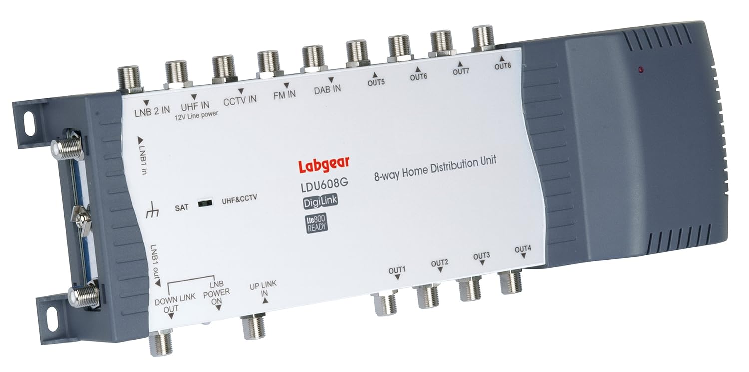

Ah fair enough, just doing a full rewire on a large house and thinking while I'm at it I'll sort her Sky etc.. Got new shotgun from loft to lounge and an old super thin sky agents crap shotgun coming into loft from mini dish so thinking if I get quad lnb and a multiswitch and then take all four from dish to multiswitch and perhaps a shotgun to 2 of the bedrooms too that would allow sky + in all 3 rooms selected wouldn't it ? doubt she'll want a tv aerial added and then wouldn't you need an extra single say WF100 to carry down the tv signal to a europlate module separately ?
81IWAgEs0iL._SL1500_.jpg This any good ? not too pricey.
Yeah that's fine mate. If you just want sky + at each position then 2 twin WF100s from dish/lnb to multi switch then twin WF100 to each position.
If the customer wanted TV for freeview then connect the aerial to the multi switch. No need for an extra coax to each position as both signals go down the same shotgun. Install a quad module in the euro plate. The quad module decombines the signals and seperates them between tv and satellite. The same for radio if you had a radio aerial all you would need to do is connect the radio aerial to the multiswitch. The quad module/decombiner does the rest for you. Installing a multiswitch for multiple satellite points - http://www.satcure.co.uk/tech/multiswitches.htm
Nice one that all makes sense then, pretty easy really.
