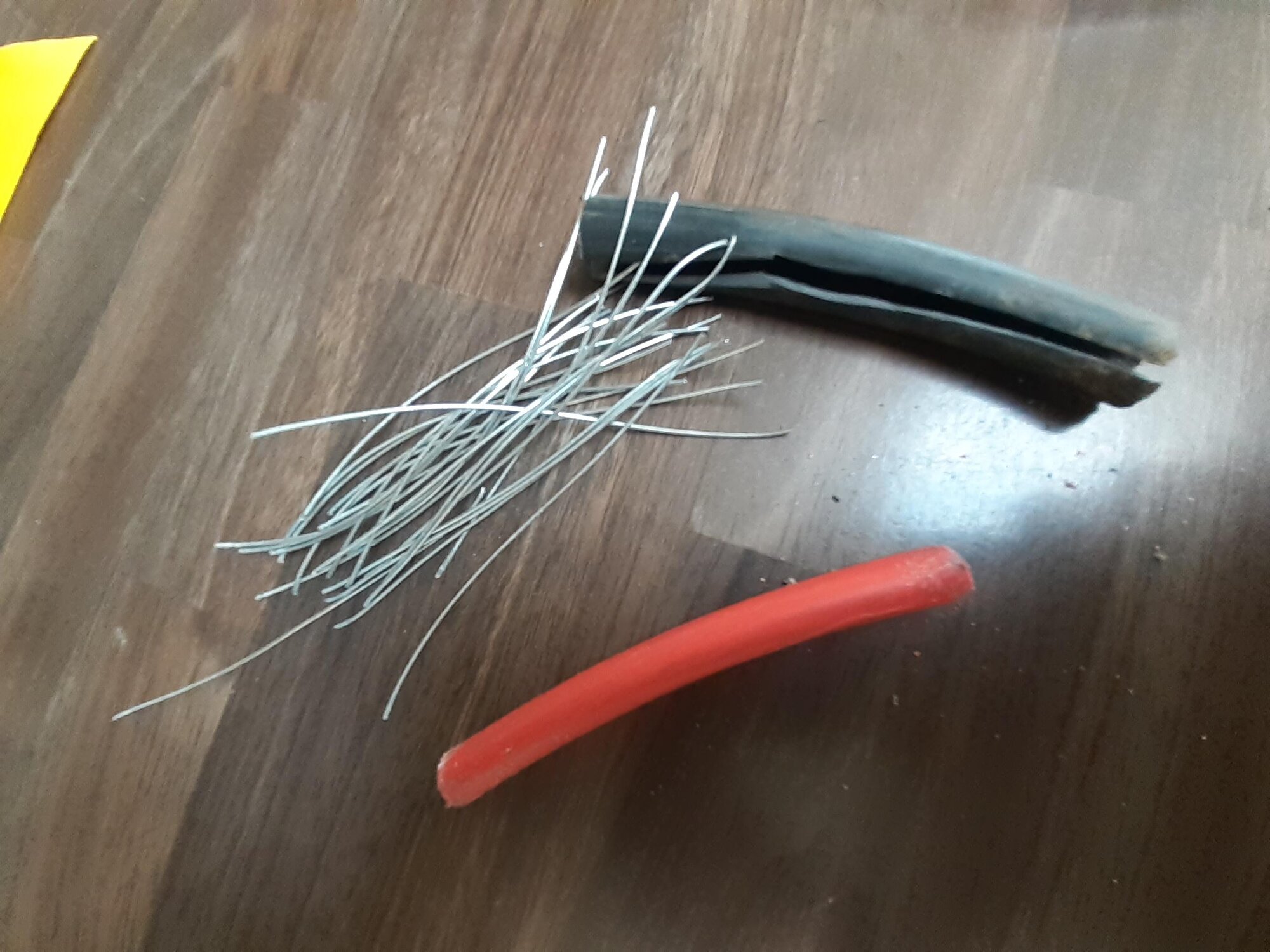

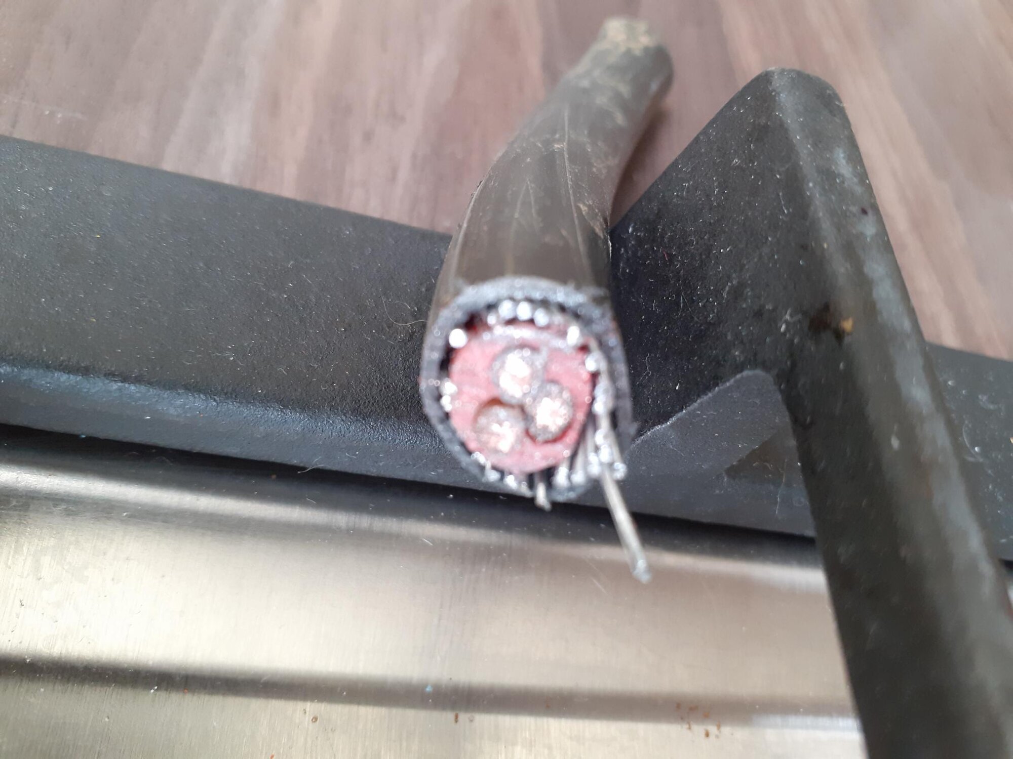

Hi All,
Thanks for all the comments. The cable was meant to be buried at 600mm but the person who laid in in that particular section skimped out at laid it at less than 300mm and the warning tape wasn't event 150mm above the SWA cable.
This cable has not yet been connected or energised so was able to check the ident. It is a 2.5mm SWA cable and was able to cut a small piece from the slack end. After the repair I will ensure the cable is installed to 600mm depth.
The pictures will illustrate the black sheath, the armour strands. You then have a red insulation inner sheath and then the individual 3 conductors Black, Grey & Brown).
This cable will be used for lighting only and the 2.5mm cable was chosen due to the long run of cable taking voltage drop into consideration.
Please let me know if the repair is still feasible?
