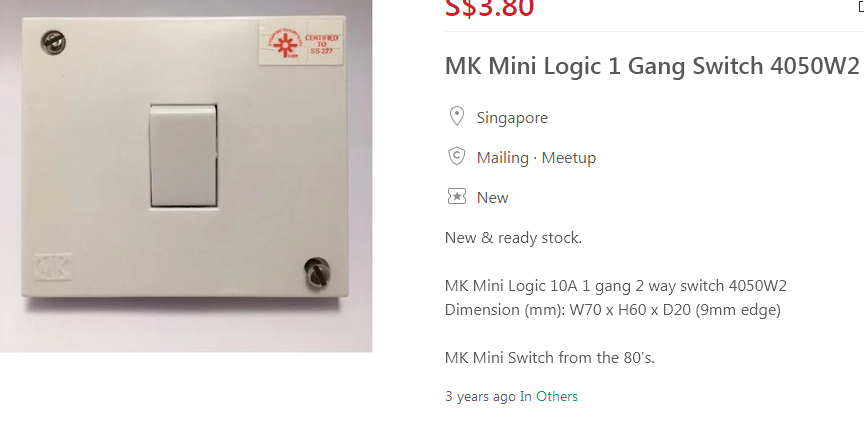

Probably the small surface Logic switch MK used to do. Came as a switch and box and was about 2/3 the size of the standard logic plateswitch.Not seen one for years
I was racking my brain trying to find one and then you mentioned them. Something like this...
They did sockets as well, similarly reduced in size... what a nightmare they were :)

MK Still list the small 1 and 2 gang sockets in their catalogue in the Ancillary Products section as 2959WHI for the 2 gang and 2949WHI for the 1 gang. I couldn't find the light switches though. IIRC they did 1, 2 and 3 gang in this size.

As for pictures, now left site. Didn't take pics because it looks exactly the same as a regular 1G switch. The screws are in the same relative position either side of the switch, so not the MK mini logic range.
Snowhead... bang on, that's exactly the size of the BT 2/1A master sockets.
