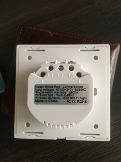

Hi , I want to install a smart switch 2 gang 2 way switch in kitchen to replace the one already there which operates the lights and under cupboard lights. What wires would go into what connections on the smart switch.
That switch will only function if you have a neutral present. You also need to reconfigure the existing two way switch connections as one switch will no longer be required. I am afraid you will need an electrician to see if this is possible.
Have a shop around. There are smart switches that don't require a neutral, but its hit and miss if they work with every type of lamp.
Lightwaverf is one I know of...
Or go down the smart lamp route, such as Philips Hue
if you're not going to be using 2 way switching, it maybe a simple job to re-purpose the 3 core/e cable to provide a N at the switch position without additional wiring.
