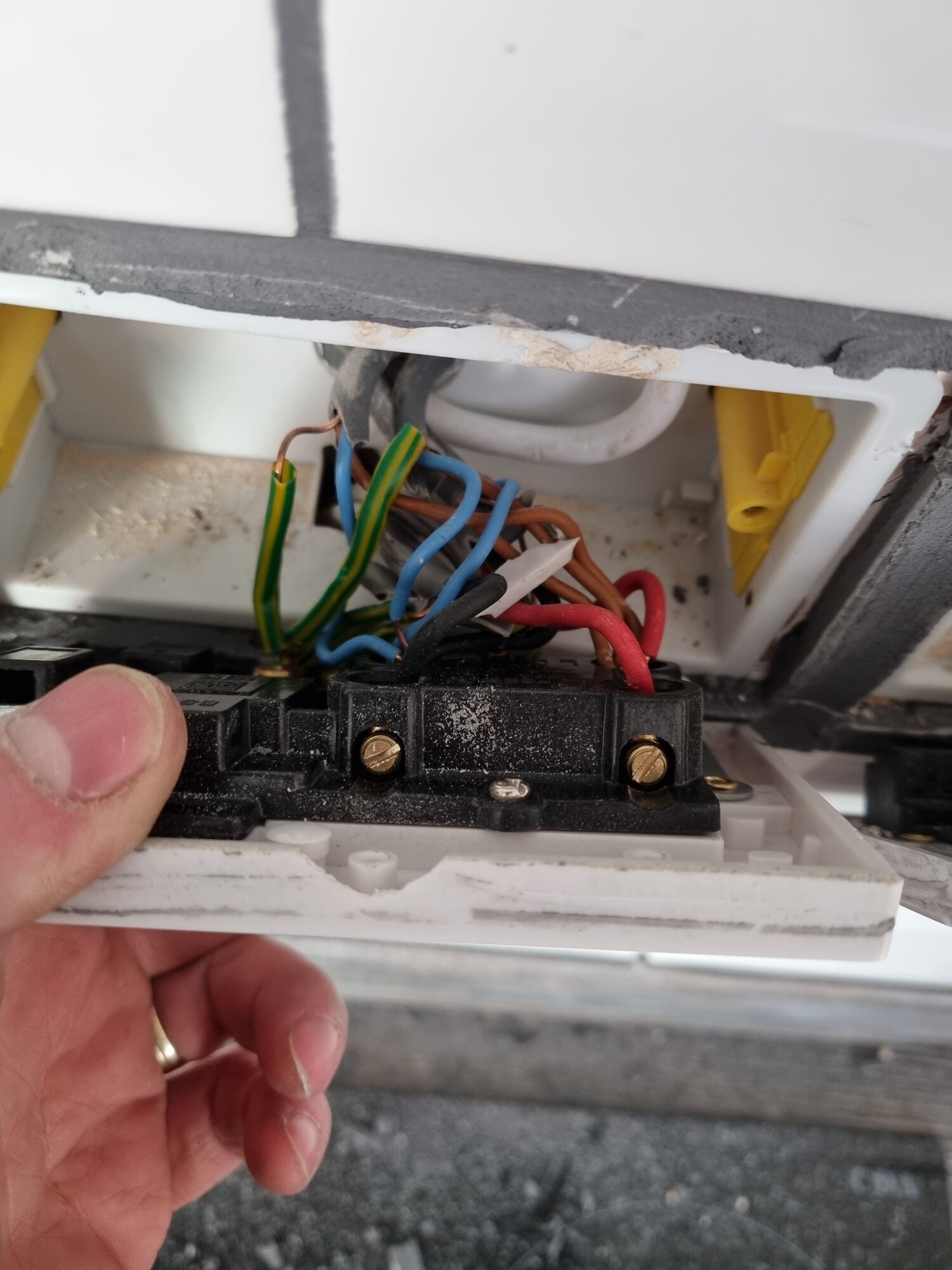

Also as a side note... the building inspector said all is fine as the electrics "weren't touched" and signed it off.... this all came after the entire job was completed and issues, lights not working sockets etc upon EICR found sooooooo many faults re wire was the only option... the kitchen had 1 dual socket above the hob fed off the cooker socket in 1mm the fused spur for ex fan spurred off in 1mm oven fed off in 1mm and the ceramic hob fed off in 1mm!!!!!! The other lad has a better picture so will try add tomorrow but you get the idea ? oh and the 30amp bs3036 had 2.5mm copper wire in it.... but yea not dangerous in any way ??
