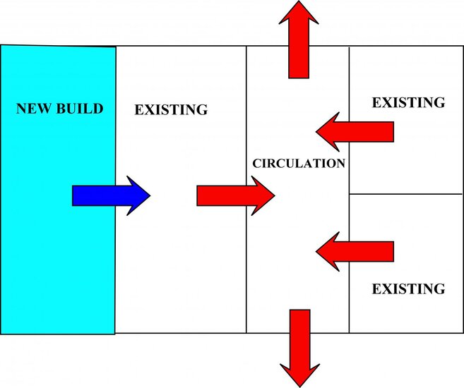

Hi
Quick question about smoke alarms.
50 year old house, no alarms.
Internal garage conversion into a study. No change to access or exits for the house.
Building inspector wants 3 inter-linked alarms in the rest of the house
1 on the upstairs landing
1 in the hall way
1 in the utility room, this is where the existing garage door is and will remain the same.
I am ok with alarms etc, but as surprised why these were being required on this build, anyone point to the relevant regulation, not just part B, but where it is?
Any other information would be appreciated as if this is a requirement on all builds like this, then changes things, unless I have missed something.
Many thanks
When you alter an existing building by loft or garage conversion, you alter the circulation area or escape route. So you have now made a new area, onto an existing area, which inturn was adjoined the existing circulation area. So you have made a room leading onto a room which leads to a circulation area........hope this makes sense
