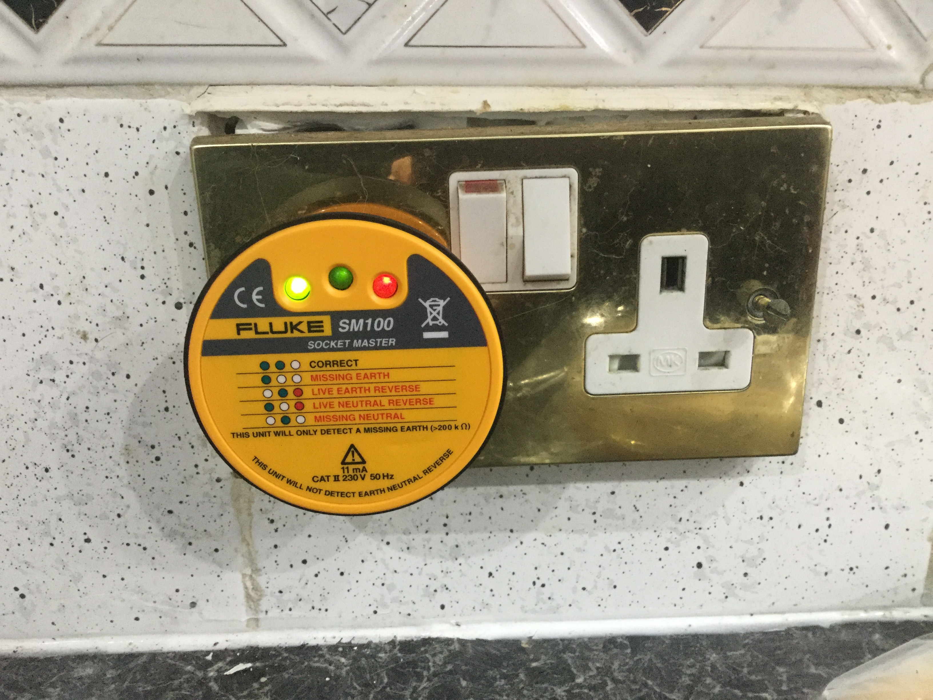

Hi all,
Never seen this before. I am getting a red LED appearing on my socket tester without the socket being switched on, and then a 'No earth' from one socket tester but 'Live Neutral reverse' from another socket tester. I am also getting the following voltages at one of the sockets:
Line to earth: 11v
Line to neutral: 216v
Neutral to earth: 62v
Any ideas?
Thanks
Hi bud,are these socket outlets single or double pole switched?
Also,what were the two testers used,and any original problem,which initiated testing.
They're double pole. The circuit was installed in around 1996 and I was told there has been no testing ever done on the circuit, even when it was installed. Someone said they were getting a small tingle when touching the socket. First thing I did was plug in this socket tester and received these results. I haven't had a chance to do any further testing yet.
