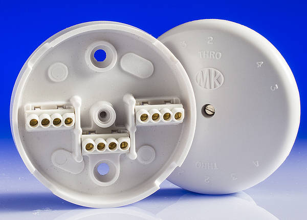

Thank you telectrix - my poor descriptions might be at fault here i used a 30 amp 3 terminal junction box, (i have uploaded an image) i have just Googled a Wago box and can see the benefit!
I will go to the local Screwfix tonight and buy one just for piece of mind!
