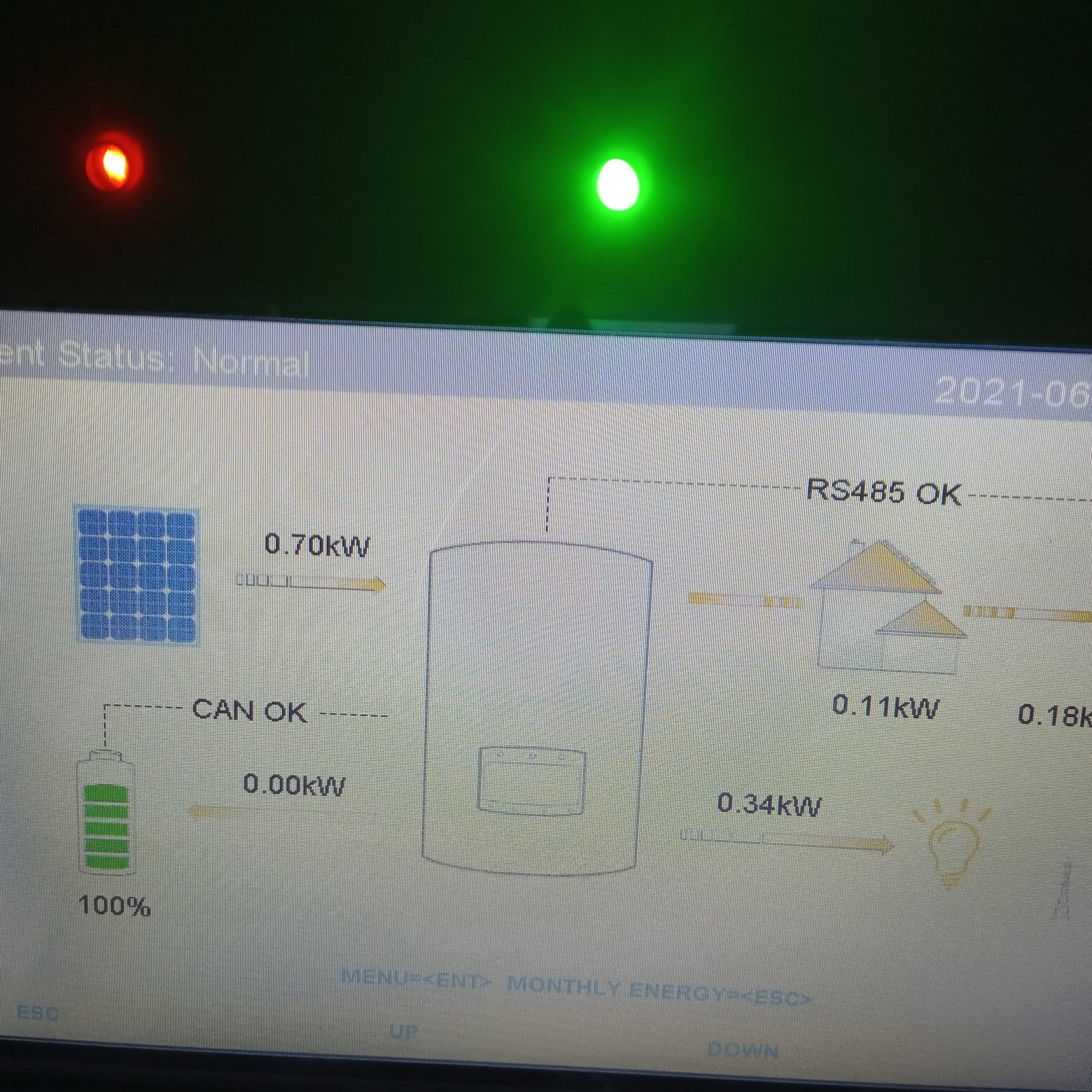

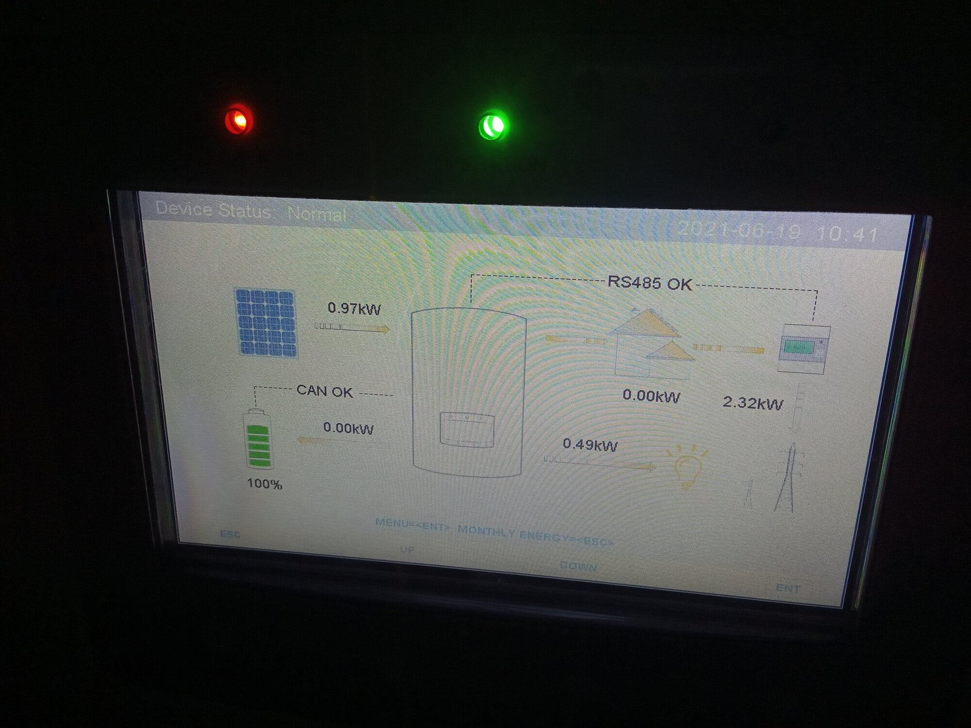

Trying to show you what happens when I put on the oven. The display shows that the export to the grid goes up. Problem seems to be that the power usage always corresponds to the solar produced therefore the batteries never kick in
Thank you. We paid a deposit then a part payment after installation. We held back an amount. We are near Perth in Scotland. Thank you
View attachment 86922View attachment 86923
The sun is shining so producing more energy. No appliances being used only fridge freezer same as the first photo. See how our power usage soars in line with the solar producedIMG_20210619_144555.jpg

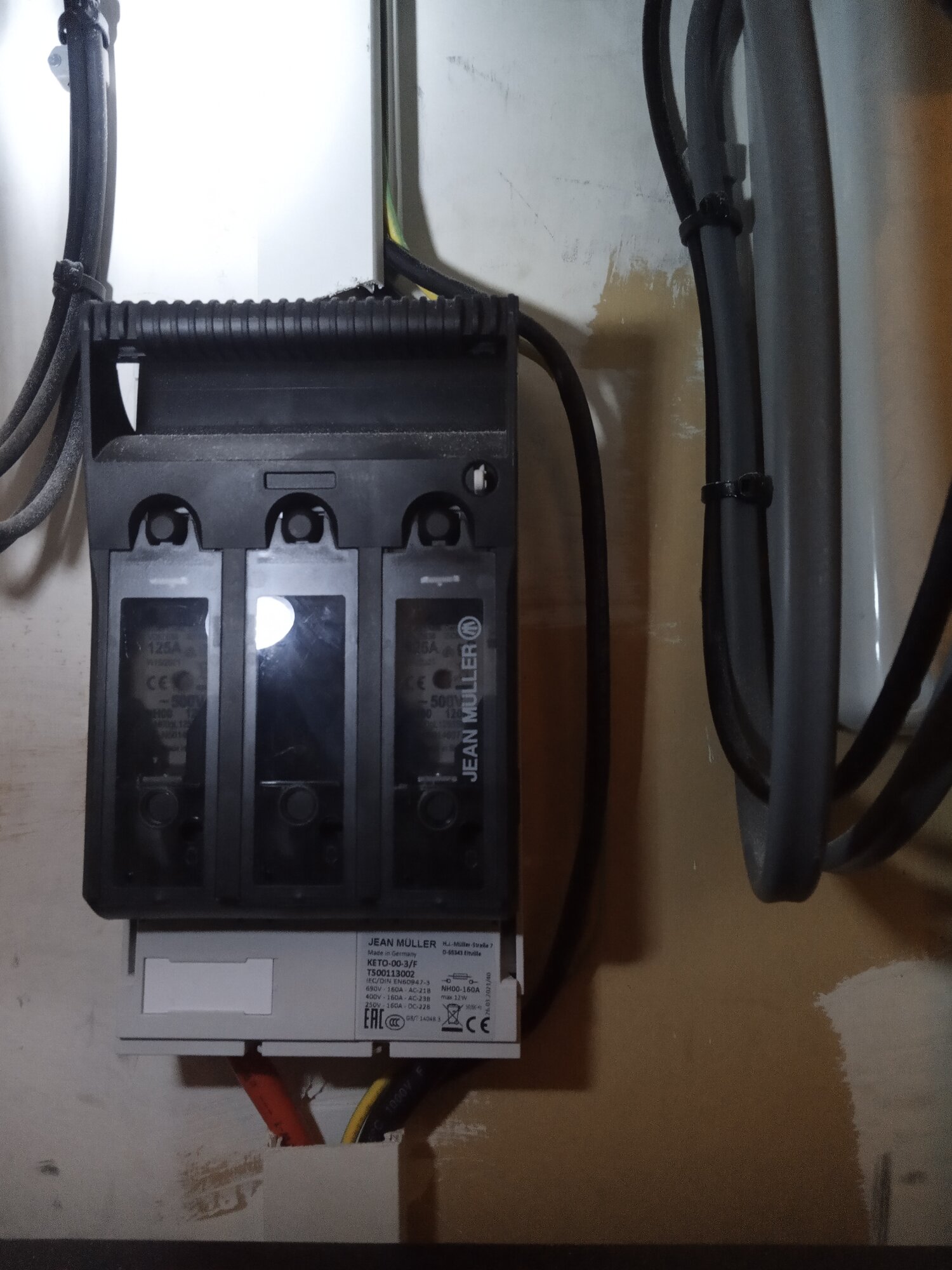

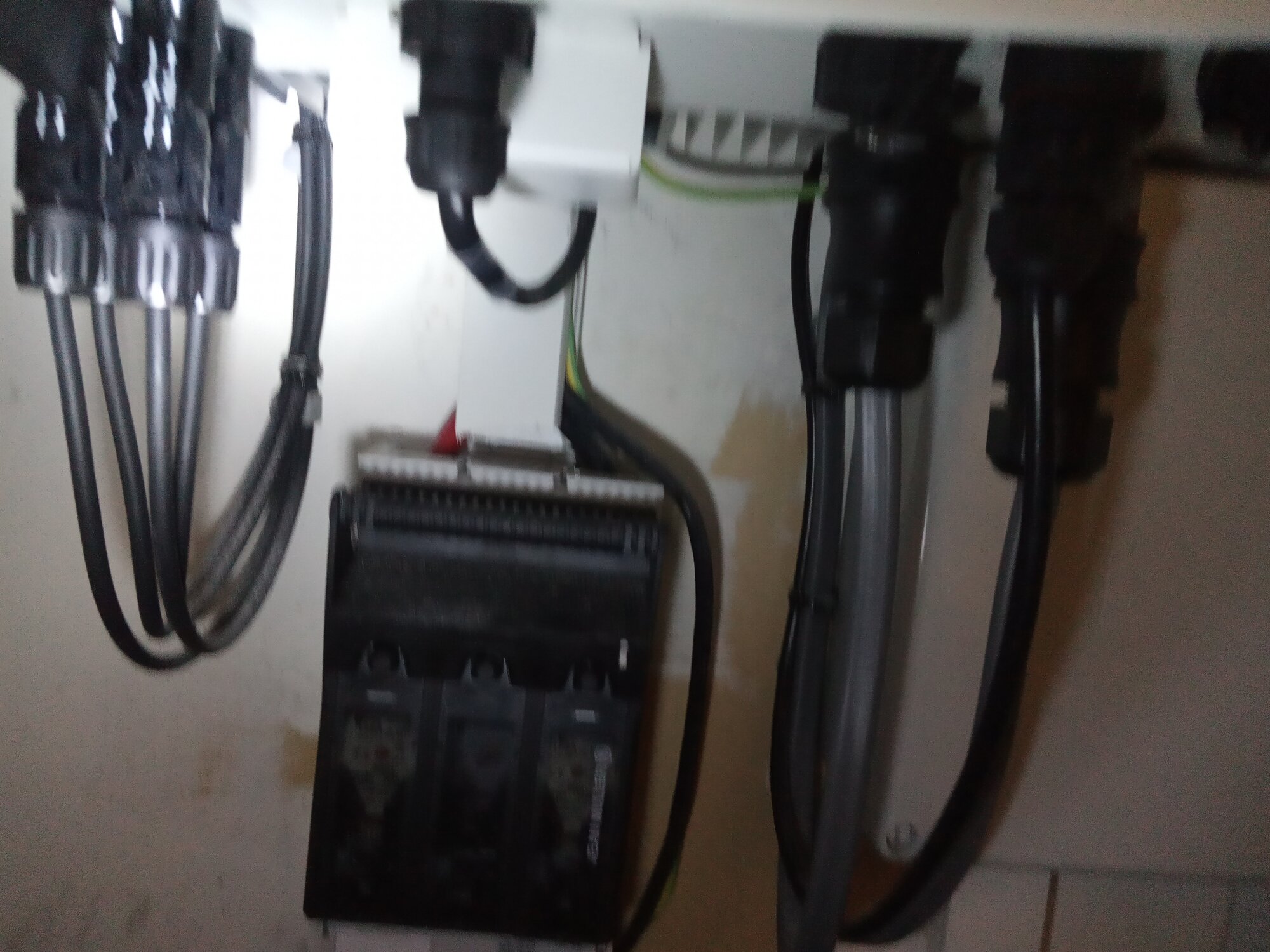

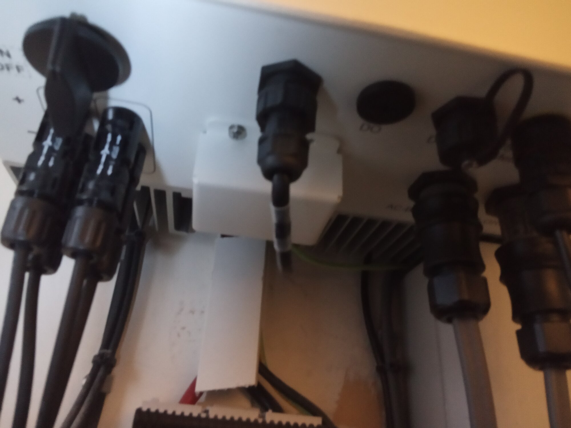

Your display indicates that the installer has made two connections to your fusebox, one for house and one for critical loads, hence the picture of a house and light bulb. There is only one CT which is measuring grid incoming/outgoing power.
Look at Fig 4.8 /4.9 and see if this represents how your installation is wired. If you look under the Solis, there are two connections , one for Grid and one for critical loads, be interesting if both have been used. I suspect they will have to come back physically to check over the connections.
A photo of the CT would be useful just to see how it has been connected
