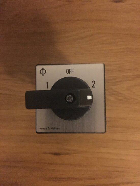

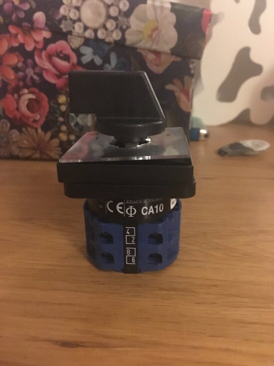

I have a new customer request next week for a solar panel switch. Solar panels are not my area of experience.

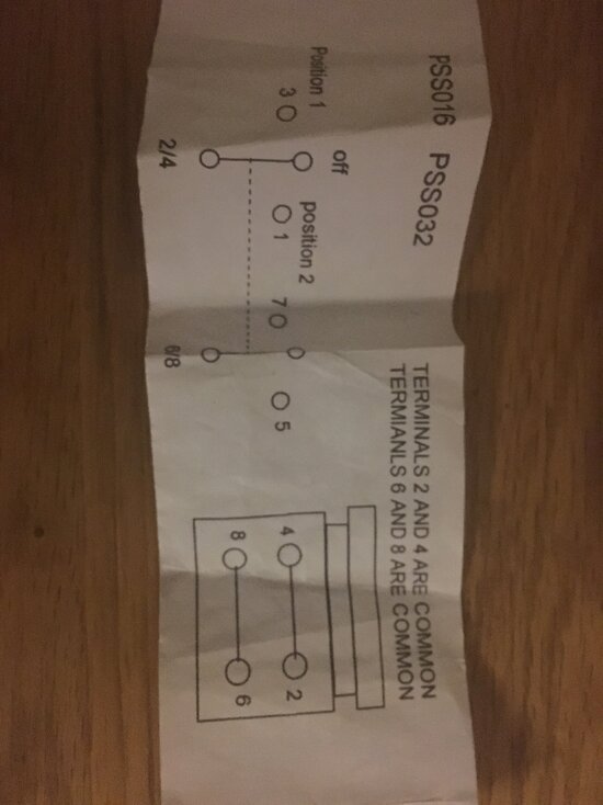

Just a quick question on the wiring for the switch I have in the photo.
Any pointers please for the wires, and which pole. Thank you
The customer plan is for a solar panel wire ( POS and NEG) into the switch. The customer wants to swap between two car batteries obviously for ( POS and NEG)
Thank you
What are you doing, charging car batteries?
Battery 1 - Positive to 3, Negative to 7
Battery 2 - Positive to 1, Negative to 5
Solar Panel - Positive to 2/4, Negative to 6/8
