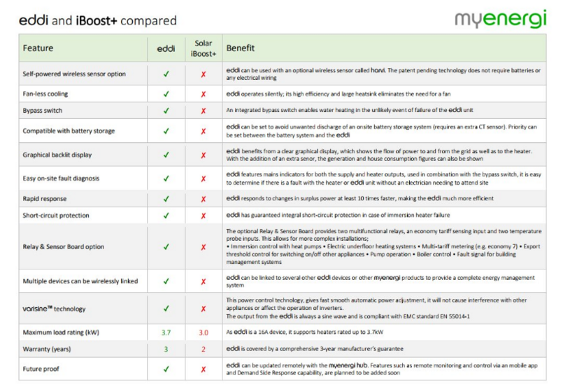

We're bringing in initial stocks of the MyEnergi Eddi, as mentioned by Worcester. If you want a comparison against iBoost, see below. Really is like comparing apples with pears...
You will get what you pay for both in terms of quality and functionality. Never forget what Benjamin Franklin said over 250 years ago: "The bitterness of poor quality remains long after the sweetness of low price is forgotten".
At £375 it would take me 250 years to recoup the cost!
