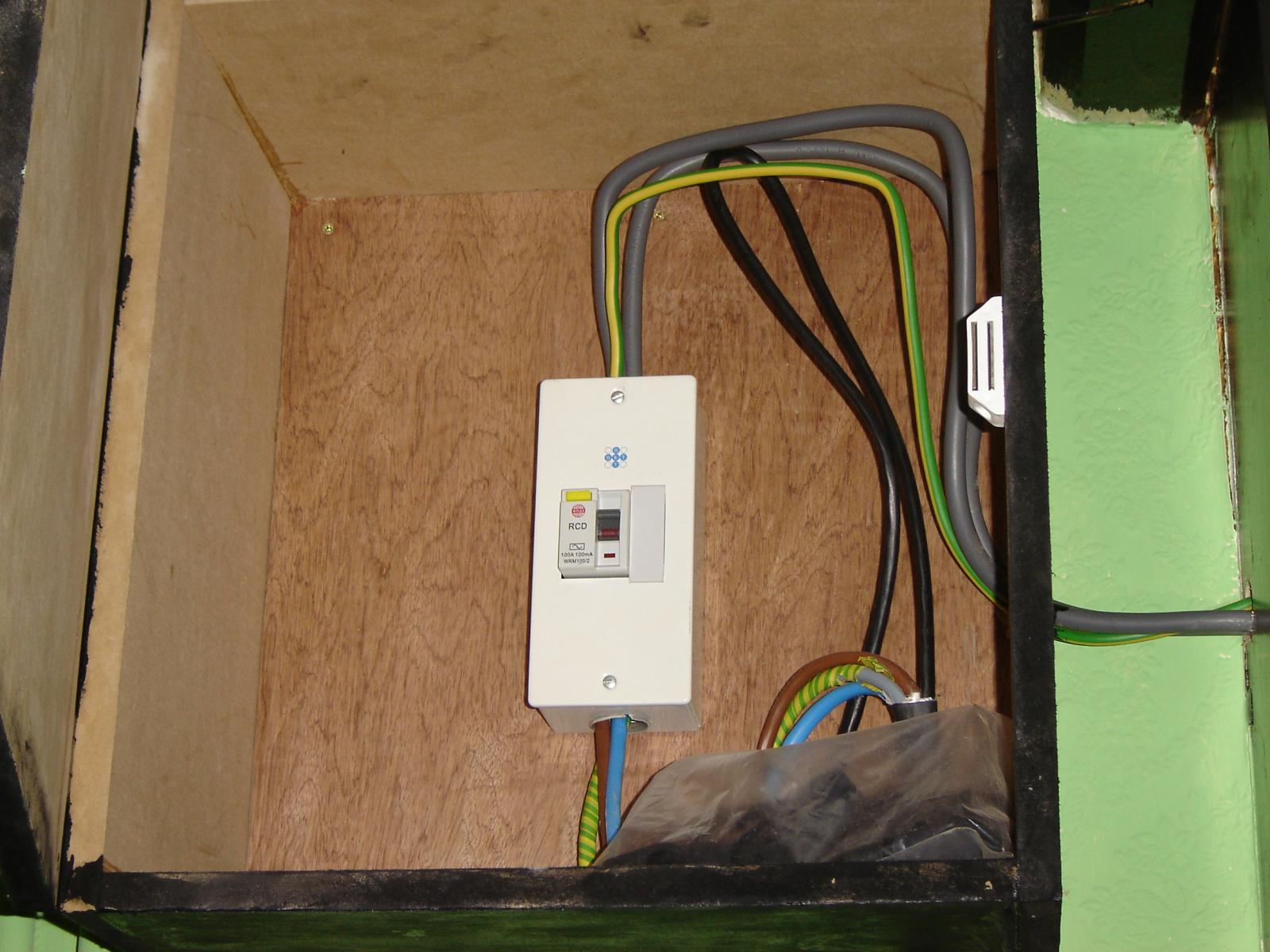

Picture 1 - S.W.A. looks like it’s a outgoing sub main. Not only is it not glanded in but the main 100A BS1361 fuse is used for over current protection. Hope you failed that part twice…lol

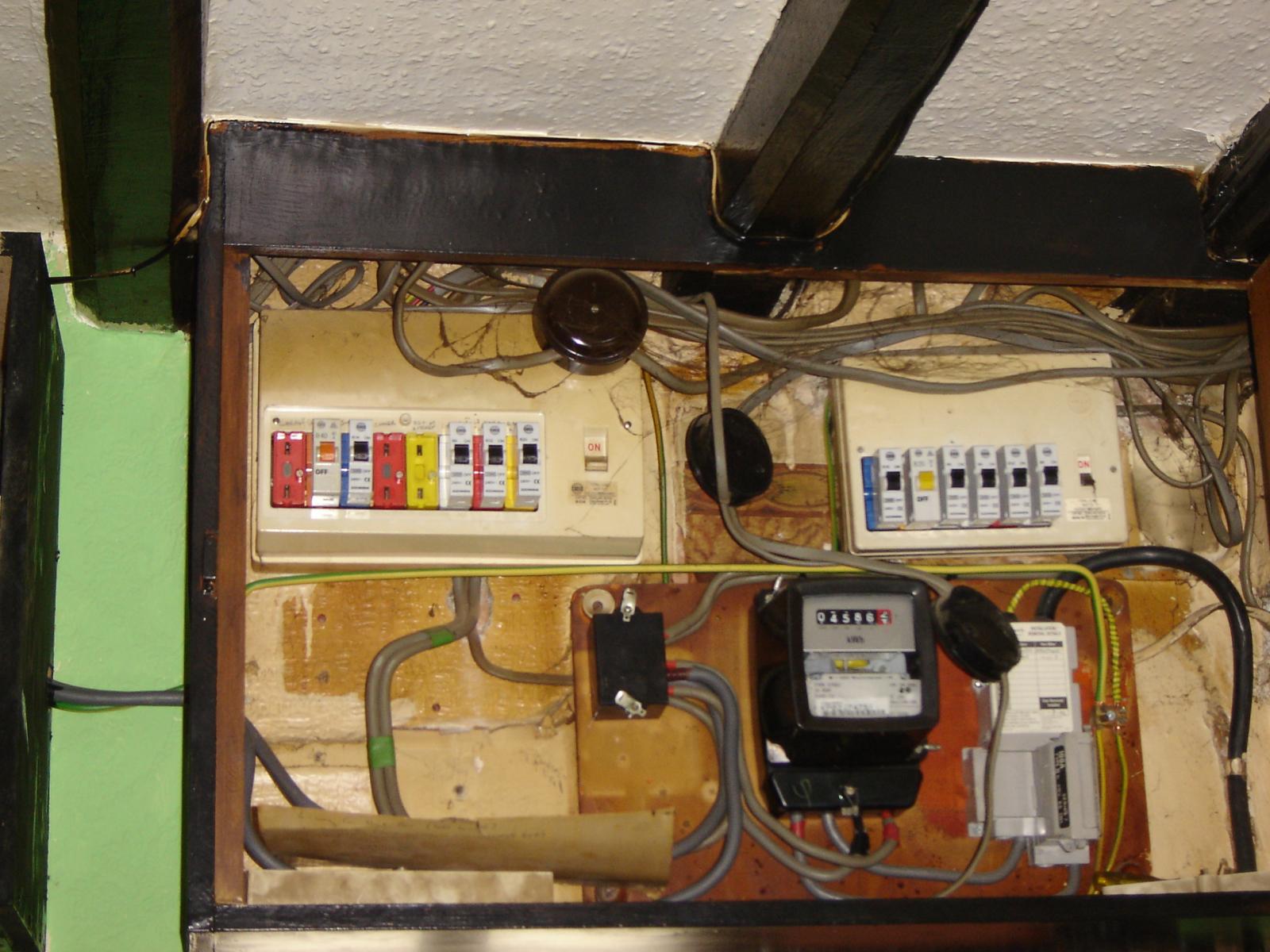

Picture 2 - Looks nice. Very Loreal…pml. ;)
