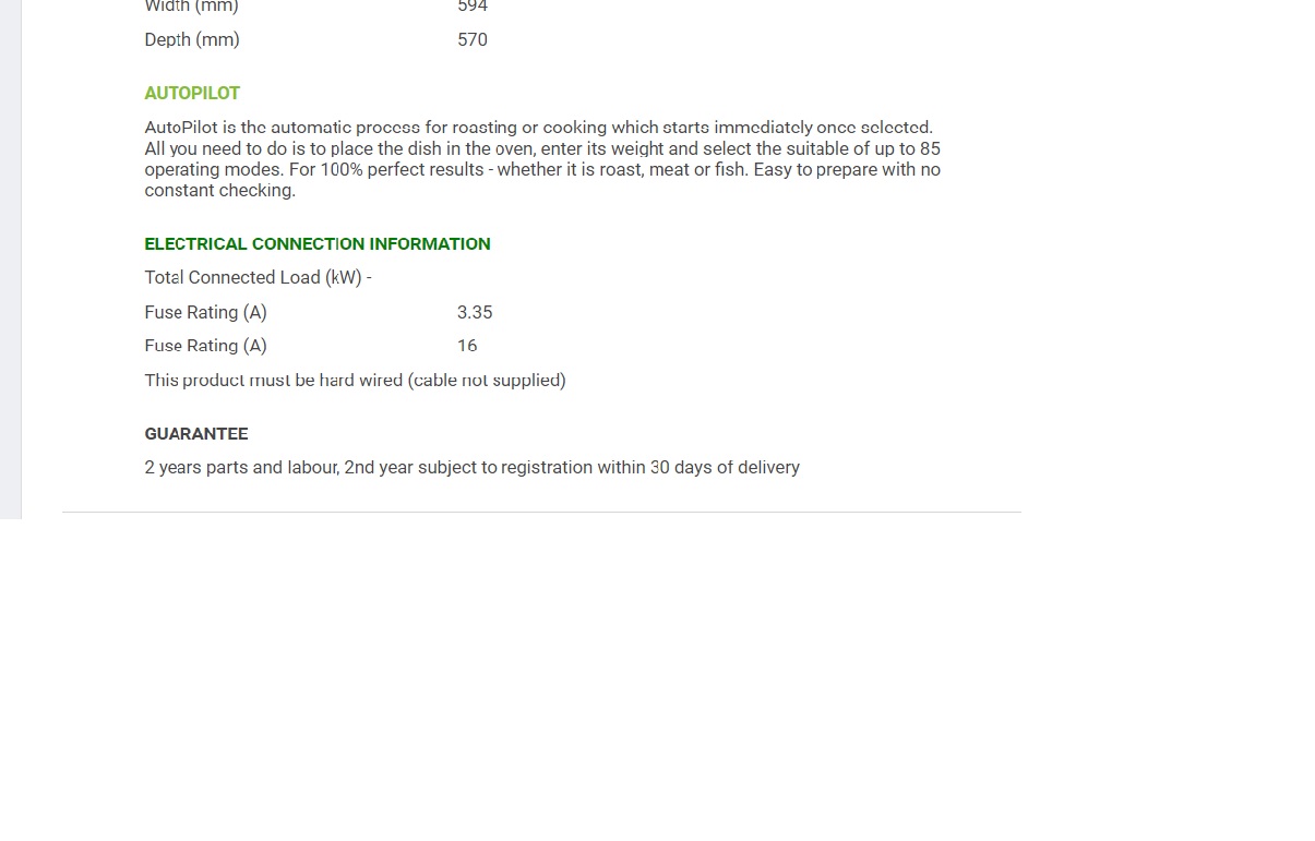

We had an electrician out yesterday to fix something in our kitchen. I asked him to check our built in microwave and he said the wattage would be pulling around 14.56amps. After he looked at the wall socket he said that this microwave should be installed on its own supply and not on a standard 13 amp plug socket. ( the power rating on the microwave is 3350 watts)
I contacted the guy who installed the wiring and he told me that he had used 32 amp wiring and this electrician was talking rubbish, but I am not sure if this is correct as the socket in the wall is just a 13 amp one.

I take it it’s a combi microwave/ grill??
Even if the cable is rated to 32A, if it’s just got a standard socket on the end, then the fuse in the plug limits it to 13A.
Who put the plug and socket on this 32A circuit?
Should have been an isolator switch rated correctly. In fact… why a 32A circuit when a 16 would have done?
Have you got the instruction book for the appliance? What does it say about connection? Or post the make and model number, we can look it up.

Hi Thanks for the reply.
I since spoke the guy who did the wiring. He told me that he has not added any new type of cabling to what is already installed in the property. He says that the ring main is running on 32 amp.
So, he explained he just chased in and ran a new length of wire, fitted a new socket to the wall and the microwave was plugged in.
He was adamant in saying all the kitchen appliances could be on at the same time on a 32 amp ring main with no issues.
The microware is a combination and is a bosch series 4 CMA583MSOB model.
There is nothing in the instructions that goes into any detail about the electrical installation though, sorry.
I guess the other electrician had some concers about the amps being drawn and he did comment that as the socket was a 13 amp one, with the oven plugged to it too it was a an issue in his opinion.

This oven is meant to be on a 16A supply, so would typically be on its own dedicated 16A circuit. However, you will likely get away with running it on a 13A plug, provided it is a decent quality (heavy duty) plug with no loose connections! This is perhaps one of those occaisions where the manufacturer would be justified in saying using a 13A plug would invalidate your warranty!
Did it actually come with a 13A plug fitted to it.
Hi and thanks for the replies to my post. I just checked where be purchased it from (marks electrical) here is the link. The unit is meant to be hard wired, so in answer to your question they have just stuck a plug on it the end!
Cable not supplied either for 3 pin plug.
well, we know who's at fault now. not reading manufacturers instructions.
The guy in question genuinely believes he has fitted this correctly which I find bizarre!
I'll have to get someone back to re wire this properly.
