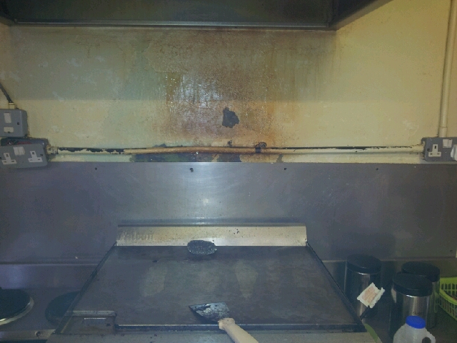

2012-04-24_13_04_30.jpgtook this in back of a sarnie shop, only reason im been called in is because the stainless splash back is been replaced by a full height one and she asked me to re-route the plastic conduit they were unaware it was doing any damage to the conduit DOH!
Once you’ve sorted it lets see a photo of the cores in the toasted bit.
Done it and believe it or not no real evidence of damage, they were 2.5 solid drawn singles too which i aint seen used for many a year, i believe the cream paint which charred up acted like a pretty good thermal barrier, look closely you can see the conduit is actually black in colour overpainted.
Nice one!
I had a sarnie shop that had coffee maker, toaster, fridge, freezer,hot plate, hot counter, cold counter and a few other things of a 2.5mm 15A radial (rewireable fuse) and they wondered why the fuse kept blowing!
After looking at the pic was just about to say , at least its steel conduit.....
lol.
And a socket above a hot-plate ( to the left ) , really useful.
Well its no longer an issue even if i was drafted in for other reasons and even got a nice sausage sarnie to go for free ;)
