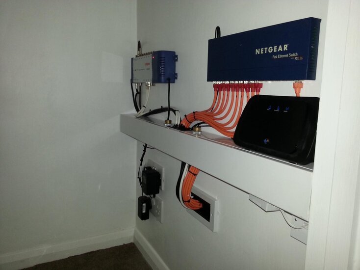

All you need is a switch. You've already a router in the house. A minimum of a 4 way, but personally I'd buy one with a bit of spare as they cost peanuts. Simply terminate RJ45 plugs on each of your cables and plug into the switch.
+ 1 for Netgear.
I finished my home network today and if I can find my phone I'll upload a picture of my setup.. I am using a second hand from eBay, Netgear FS116. Think I paid £18 last year for it and is currently working perfectly with my youview and PS3 along with the missus mac.
