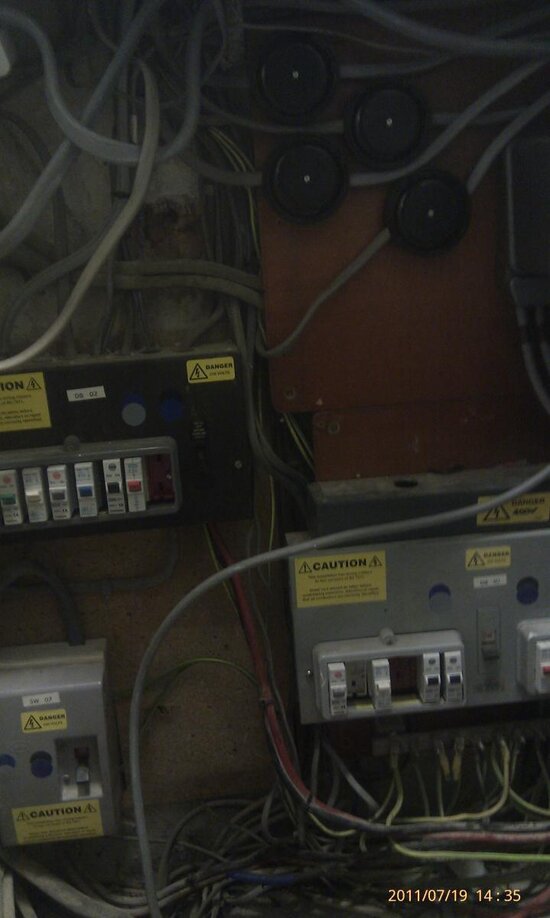

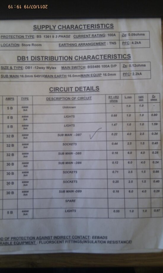

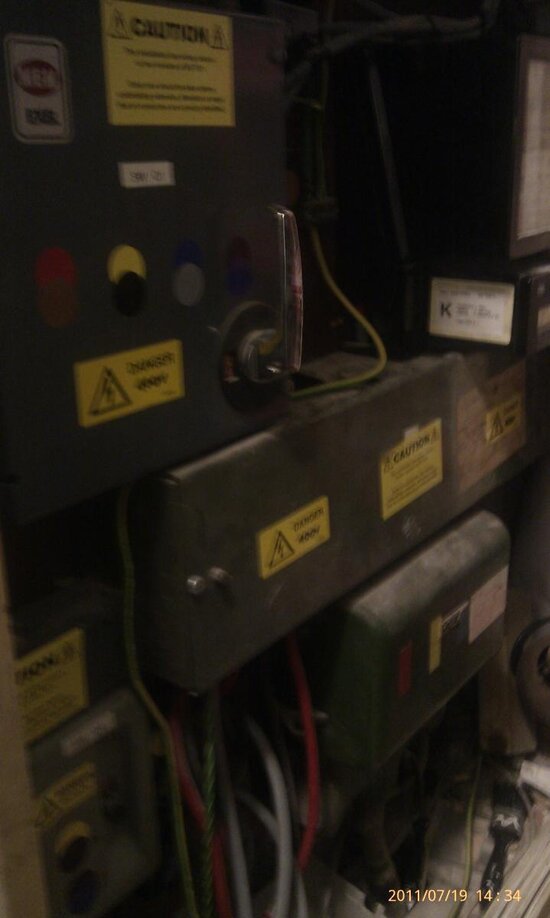

I went to look at a hotel today, the first thing is the old boards which have various gaps and 3Ka breakers JB's everywhere, and look at the recorded results !!IMAG0304.jpgIMAG0305.jpgIMAG0306.jpg

I have seen this quite a lot. They used to say that you were not allowed to do a ZS reading at any point other than a socket due to the exposure of live parts (with a socket you can use a plug top tester) so the only way to get a Zs was (R1+R2)+Ze, the R1+R2 that is lower than the Zs is most likely due to a parallel earth path (eg bonding) and as this was the only real test, shows in the results. Not sure what the norm is in regards to Zs testing now, I just throw the covers off and get in their with my tester.
i was thinking on the lines that they would have stayed with one method of testing the circuitsi, ie all the rooms have one 2.5 T&E radial for one socket and one 1.0 T&E for lighting, so surely if the Ze is recorded as 0.09 then for instance if you add the R1 + R2 of 0.71 the Zs should be 0.8 ? or is it me being a bit dumb lol
by calculation, you are correct, but due to parallel paths (water pipes etc.) to earth, the Zs can be lower than calculated. this is most noticeable in TT systems where the resistance to earth through services is less than the resistance through the earth rod.
it just didn't look right to me, this is just one sheet of many for the various boards around the Hotel and they all vary, i just thought the results would be similar on the other boards and circuits if there were parallel earth paths, plus i looked for supplementary bonding but couldn,t find any only main bonding so far, ( I must be on a bad day lol) and its TNS
This is why the Zs-Ze = (R1+R2) formula should never be used as it makes no allowance for the parallel paths that exist in all but the most basic of 'all-insulated' installations.
take a few readings and compare with them. that should give an idea.
i,m back ther tomorrow so will start taking my own readings, i was going off the existing readings today for an overview of the existing installation
i think i need to review my test procedures , i have always measured Ze at the supply incomer, then R1 + R2 and added them together obviously not allowing for parallel earths, you learn something new every day on here and i dont mind admitting it
i always measure Zs unless by doing so i might create danger for myself or others. to give an idea of the effect of parallel paths, measure Ze as normal with the main earth dissed. then measure again with it connected. you should find the 2nd reading is lower.
