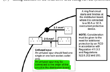

It looks wrong, personally I would have just put it on its own 20a breaker. But when I thought about it, how different is this setup to spuring off the ring elsewhere? You are still going to junction 3 cables together at some point, what is the extra risk of doing it at the breaker? It will make ring testing slightly more awkward, but otherwise?
There is nothing wrong with a spur at the origin (at the circuit breaker/RCBO).

I thought this scenario was always ok but a colleague debated with me and said spurring from a breaker means that It’s now a 2.5mm radial off a 32amp breaker.
But thats only the same for a single socket spurred off another socket on a RFC.
What needs to be ascertained is how many sockets are being fed from this spur.
Taking one from anywhere on the ring is fine, but can only be one point. (A point being the maximum of a double socket)

It isn't a radial circuit, it is a ring circuit with a spur.
It would only be a radial circuit if the ring was disconnected from the OCPD and just the single cable connected.
The crux is that to qualify as a safe and compliant unfused spur, as mentioned above it must only serve one point, which is what prevents the cable being overloaded. It doesn't matter whether it comes from the MCB or some other point in the ring.
A 2.5mm² radial connected to a 32A MCB serving multiple points would indeed be non-compliant, as would an unfused spur from a ring serving multiple points, regardless of where it is connected.

It's always good to remember that BS7671 is not a design guide; it's a set of rules and recommendations to inform a best-practice design decision and deviation is perfectly OK so long as it affords no less level of safety and stands up to scrutiny. It's the difference between an engineered solution and join-the-dots Ikea style.
I'm glad I sparked a debate on this, seeing different perspectives. Seeing that snippet from BS7671 cements it for me, probably ok after all.
That is so long as my assumption that it's just a single socket is correct. I'll be checking it properly at the weekend to see what the situation is.
