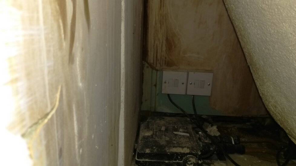

I am a plumber who has just come across this (sockets/spurs under bath) is this permitted?
There are 2 fused spurs and a digital shower unit under the bath. I am concerned as the bath seals have gone causing water to drip onto the fused spurs.
Has the electrics been fitted to regulation? If not then what should have been done?

1.is it accessible, could you comfortable get to it to work on the Fused Spurs. ? 2. is the likelihood of a leak likely to happen ? 3. is it protected by an RCD?
for a start I don't like it it looks pony, it certainly wouldn't pass mustard in my house.
If you can't work on it then its not accessible, therefore it will not be complaint with the wiring regulation. every point needs to be accessible for purpose of inspection and repair.
Consideration has to be given to other service,ie Water service in close proximity to electrical service, so when ever installing an item ie Fused spur/ Socket, its require to take this in to consideration,
if there is any evidence of water leaking on to the fused spur, I would say this has fail the consideration to other service.
I personally think it fail any way and would have gone for an IP rated Fused spur if had to fit it under the bath. I would of also of built a wooden frame off the wall so it located under the bath and therefore even less likely to have water drip down the wall on to it
As its a bathroom as well it a special location and should be protected by an RCD.
Either way the customer should get themselves an Electrician out to check it over.

I don't get why anyone would put the FCU's behind the bath (I assume this is the case). If there is no other option but to put the FCU under the bath I would put it in an accessible place just behind the bath panel and in a position that is least likely to get water ingress in the event of a leak.
I do bathroom re-furbs, in my experience there are cowboys in both trades (plumbing & electrics) there are also some decent professional folk who actually take care and consideration.
Granted an FCU behind a bath is not the most suitable location, for the reason Murdoch highlighted. However, it is possible that there may be circumstances that one would need to be located in such a place, or indeed a flex outlet plate may need to be located there to feed appliance, as previously mentioned.
It is for the designer of the installation, to make these judgements to comply with BS7671. Chapter 51 advices of guidance on, compatibility, external influences and accessibility. Reg 528.3 advices of guidance on proximity to non electrical services. I expect there are others.
