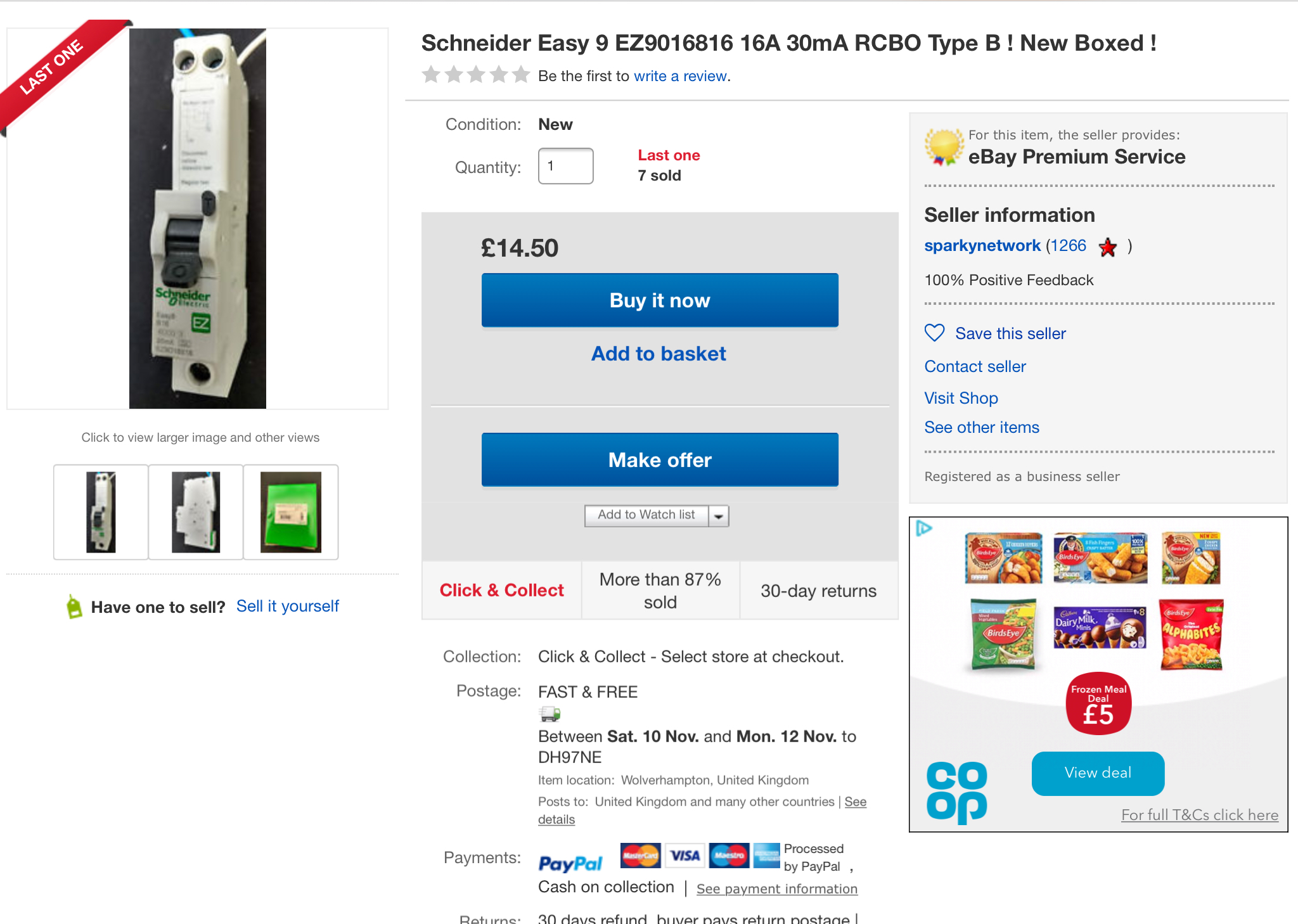

You can get RCBO's for that board. Like here. I'm not sure if Schneider make new ones for it, not familiar with that range, usually just see the older QOE (eyewatering prices for RCBO's) and the KQE stuff here.
Good spot that.

I think I’ll dead test one of those ring finals, and if all OK, fit an easy9 RCBO and incorporate the new socket into the ring. I’d have a warm glowy feeling if I left a whole circuit RCD protected. I don’t think the materials would cost significantly more anyway.

In its place I put an Easy 9 RCBO - put the kitchen ring on it, as well the FCU and socket the customer wanted (there is going to be a worktop between the two).
The RCBO fits perfectly, though is a tad bulky, and I would not want to try and squeeze one in a congested board.
