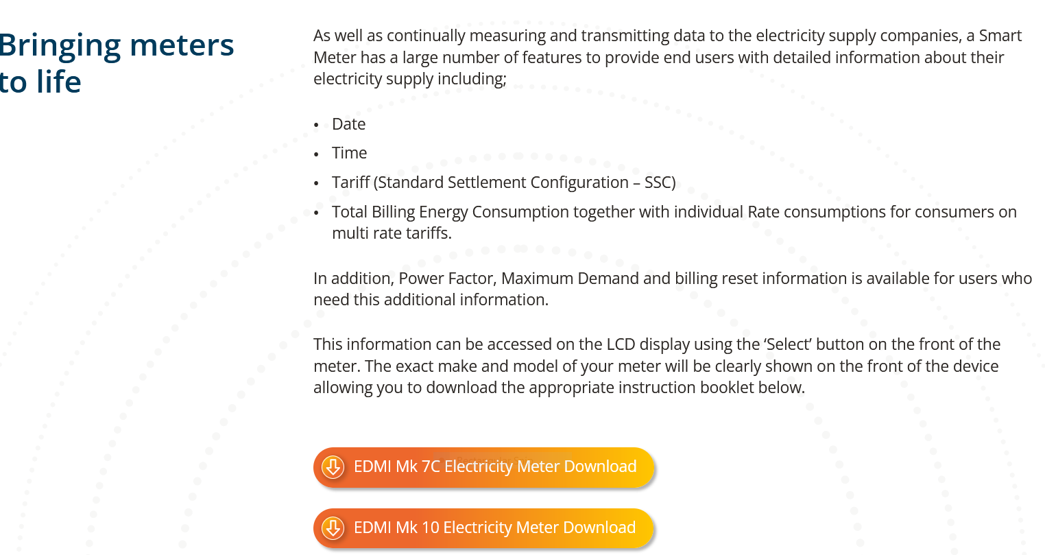

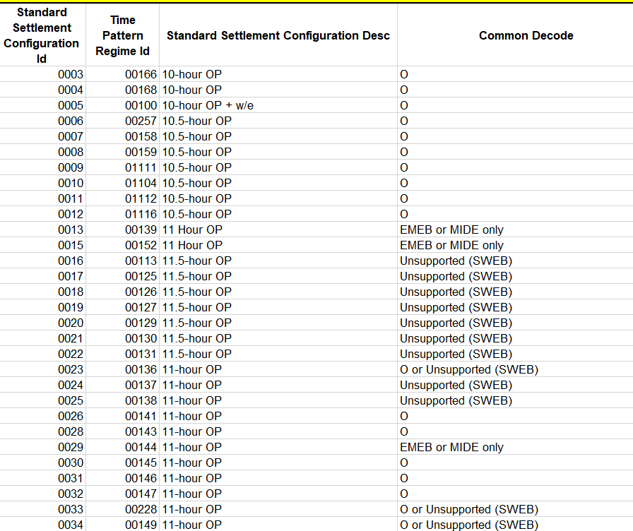

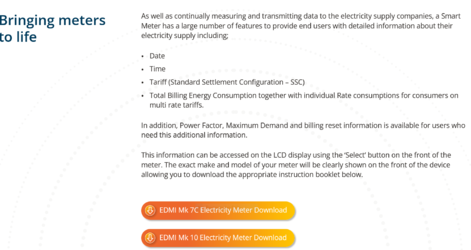

SSC,
Standard Settlement Configuration
SSC appears to be the DNO description of the various Off Peak rates like E7 etc.
It looks like there are loads of older peculiar switching patterns, which shouldn't really trouble a "Smart Meter" except "Smart Meters" aren't Smart and this would appear to confirm it.
There's over 1000 configurations mentioned on a spreadsheet, just a few here,
SSC metering expanation , why cant a smart meter be fitted SSC table.PNG - EletriciansForums.net
SSC metering expanation , why cant a smart meter be fitted SSC.PNG - EletriciansForums.net
Yes .. but how is this preventing a smart meter being fitted.. ..
No idea why.
If the meter is set to an old pattern then it would have to be changed to one that "Smart Meters" can cope with.
