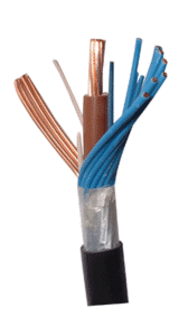

Domestic, three phase supply, one phase to each of three consumer units. Two consumer units are local to the intake, the third CU is on the first floor.
Currently the first floor CU is fed via a fused isolator at the intake. The replacement CU will be rcbos. However, we thought this submain was SWA, but discovered today that it is split concentric. Soo, looks like we now need to apply additional protection to the submain as it is buried in the building fabric.
We want to achieve discrimination with the 30mA rcbos in the new board, so is a 30mA time delayed rcd replacing the switch fuse acceptable in this situation?
Also, we would prefer to provide overcurrent/short circuit protection via a fuse, as opposed to an mcb. I recall there are fuse holders which fit on a DIN rail, but not sure of make/spec - anyone point me in the right direction?
Oh, it’s TNS, Ze of 0.34.
TIA

You aren't left with a lot of choices unless the customer is willing to have the fabric of the building disturbed. The only real option you have is to have a 30mA RCD at the switch fuse end and a main switch board and circuit breakers at the end of the distribution circuit. If you were installing the distribution circuit from new you wouldn't even consider this option. If you assess the situation and take all risks in to account ...How likely is someone to nail/screw through the distribution circuit? Is it acceptable that the end user has to travel down a few flights of stairs to reset an RCD? Not to mention the fact you aren't working on the distribution circuit and only replacing the board at the end of it so there is no requirement for you to provide additional protection to the distribution circuit.
I’m my opinion there is an interesting question here.
Does a split concentric cable with its outer neutral conductor provide equivalent protection, if penetrated by a conductive object, to that of a cable with an earthed metallic screen or armour?
Particularly in the case of TNCS where neutral is reliably connected to earth at the cutout.
My train of thought with this is heading towards whether this would be a justifiable departure.
I believe although I maybe incorrect that these types of cable were deemed to provide protection when concealed in walls but it was later amended and removed. I am certain it was okay under the 16th Ed but disappeared from the 17th Ed.
also, if cable is buried, is it < 50mm from surface?
I would try to see if the distribution circuit cable is in the wall further than the 50mm eg in boxing/void as you are only changing C.U as said there is no need to RCD protect the cable if you did it would have to be a 30mA RCD which will give no discrimination if you want to provide some sort of RCD protection then recommend 100mA time delayed.
if its split concentric then the neutral is only really actually single insulated isn't it..... and we normally give single insulated conductors that arent in trunking etc a C2. Imo I wouldn't want to leave it personally
