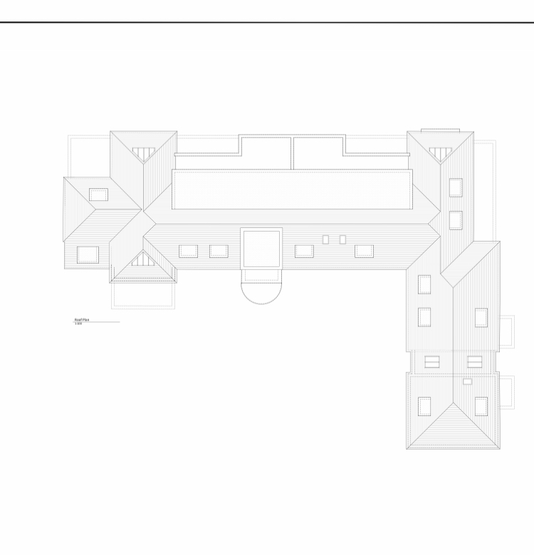

Hi all....I’ve got a block of flats I’m doing the M&E on. It’s just design stages atm and there is a basement where the central boiler system and switch room is going. The problem I’m having here is that this is the far left hand side of the building and the riser is pretty central. Far from ideal but I’m running out of options and would like to run tray through the ceiling void between ground and 1st floor which is essentially a fire rated, plasterboard, dropped ceiling in one or two of the ground floor flats. Can anyone think of a reg/building reg that would prevent this. This is a conversion of a private school to 18 high end flats. Thanks
As long as it is properly fire stopped where it enters the riser, and other places it passes through the fire barrier I doubt it will be an issue.
LSF type cable too of course.
Have you asked the architwat and/or building regs people?
I have but the Architect is an idiot....he’s good at pretty pictures and that’s about it lol.

Here’s the building
Basement under the red circle and riser blue circle

Same thinking as DS, the boiler room and riser spring to mind wrt fire stopping and possibly between flats. I believe the building regs submission will detail this.
There are some specific products available for cables and pipes (cannot remember the product name of hand but i used them on a petro chem site . They make a nice neat job of fire stopping using glands, however there are also lots of foam type products that can do the same thing. I think at this stage if you put in 3 to 4 figures for complying with building regs fire compliance that would be prudent. I guess there are going to be a substantial amount of SWA leaving the plant room to the riser so you have the weight to consider and what you can fix to that can handle it.
