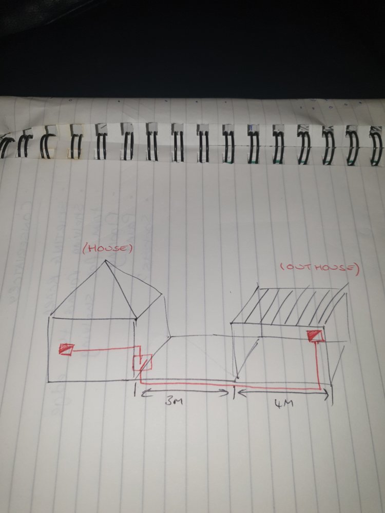

I have a summerhouse 4m long, 3m away from the fabric of the house (please see mock up sketch) I plan to have in future proofed which is why I wouldn't just have a fused spur from an RCD protected circuit. I already have an armoured cable in the ground which will be supplied from a spare way in the house consumer unit via a 10mm T+E with an isolator between the two on the external wall of the house (not yet connected obviously) - The T+E is clipped direct at height through the garage at the side of the house. Have been advised to install a weatherproof CU at the summerhouse with an electrode to create a TT system and only have the SWA earth connected at the house CU end (apparently the NICEIC dictate that you have to stake it). This is the way I will do it, i'm not arguing against it but thought i'd try and get some further clarification for my own benefit in the future.
My question is really whether a TT system is beneficial when the additional installation is so close to the house if the CU will only be supplying radial sockets and lighting, no extraneous parts in the summerhouse, no hot tub (yet - Although I do know if there were one it needs an electrode). the slabs in the garden will be at the same potential as the house and the summerhouse is timber construction with the decking. Surely exporting the earth 7metres and having the whole summerhouse supply off an RCBO from the main CU in the house is safer than having an MCB supply out to the outhouse and then staking it?
Who has advised you to do this and which regulations did they use to support their advice?
The NICEIC do not dictate that you have to 'stake it' in the same way that they do not dictate anything about the way you install things, they only state that youust comply with the regulations. The assessor will ask you why you have installed it the way you have and exoect you to be able to explain why you did or did not use the supplied earthing system.
For clarification setting up a TT system for an outbuilding is only usually needed if there are extraneous parts in the outbuilding which need bonding but the cost of running a suitable main bond is prohibitive. For example if you are running a 32A supply to an outbuilding with extraneous parts but the installation requires 50mm main bonding, it would be prohibitively expensive to run a main bond to tbe outbuilding.
Special cases or locations may also require setting up a separate TT system.
