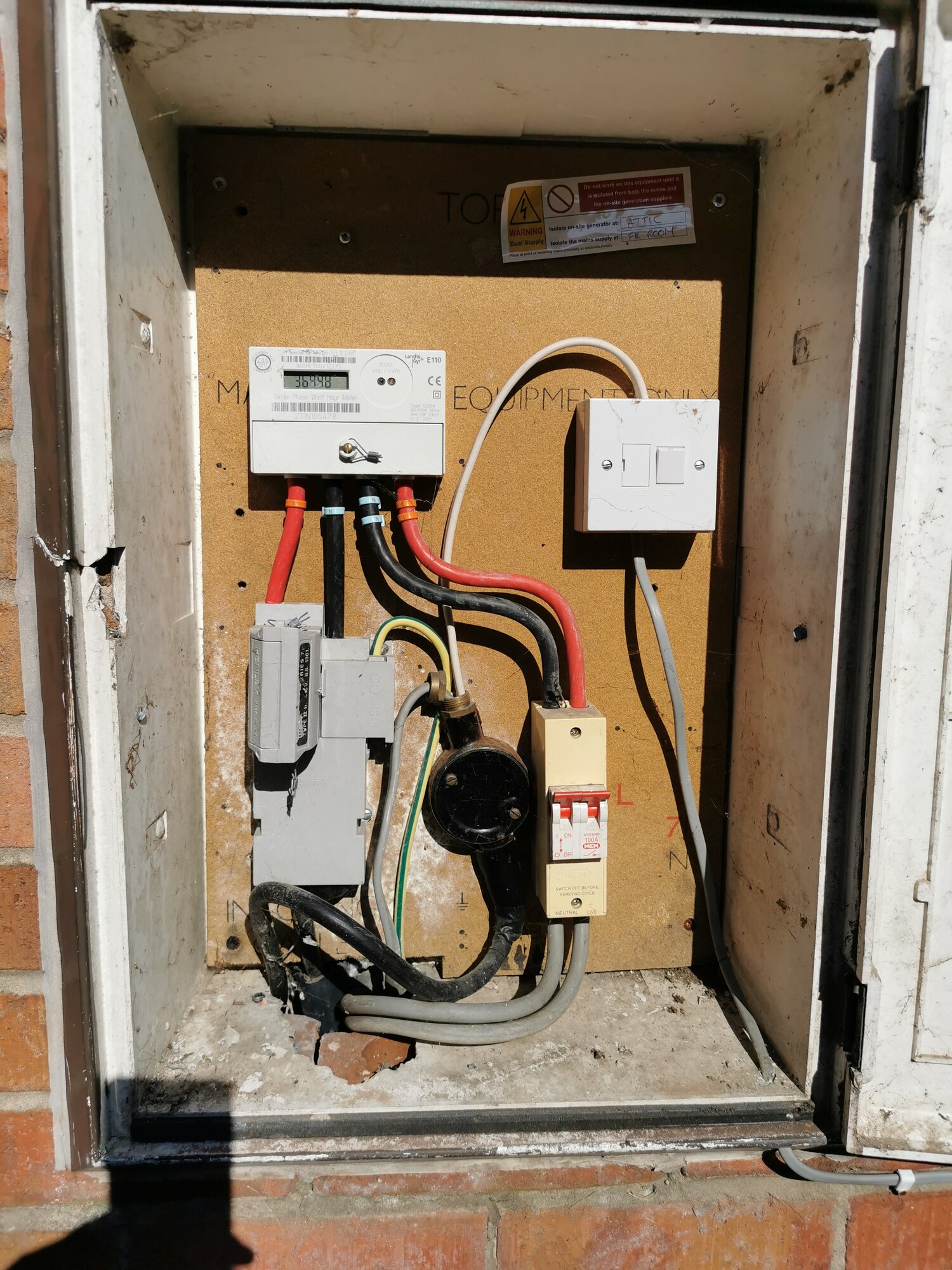

Take a pic of the incomming supply to the house and meter area. post it up here.

There's already an isolation switch by the meter ?
I had assumed you'd also need something else or the only protection the 12m length of SWA has is the 100A supplier fuse?
Pic of incoming supply attached.
The tap off the joint to the existing SWA was like that when I moved in, shocking isn't it (boom, boom)
