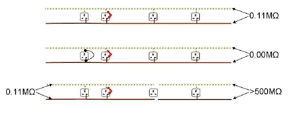

Hey all, just got all accessible legs of offending rings out and drew up a diagram, now if I was to short out say from cu to first socket outlet L-E with a jumper & put crocs of IR tester on other L&E could I effectively test insulation of one leg loop at a time to find duff one or would tester not entertain that ? Just trying to avoid rewire of all old legs
To test for the fault and narrow down where it is you need to break the circuit up.
Connecting any sort of jumper between points will simply ensure that there is zero (in MΩ) resistance between those points and along the rest of the circuit. So you will be in a worse situation than before.
I have drawn a diagram using only line and earth of the effective circuit for a ring with both legs separated out at the cu and a fault at the second socket.
It is not in ring form but this is what you have in principal.
Then with a jumper across L-E at the first socket (not exactly what you said but I could not follow that statement)
Then with the legs of the ring separated out at another socket as well and testing each end of the ring.
