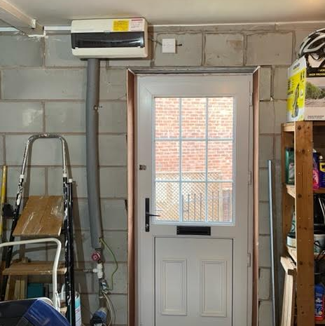

You might remember this delight from the dodgy trade pictures thread....
The next instalment of the chicken and egg mystery 1668080446252 - EletriciansForums.net
I finally got back to quote for sorting today.
The chicken and egg question was whether the plumber or the sparks did this. The confusion was there were no fixing holes visible from a previous position. Yet the water pipe is in line with the incoming supply arriving in MPDE though a screed floor. But the insulation is stripped back suggesting it was once in a sensible place.
It was when I noticed that next door's identical house didn't have the door that I was using that the penny dropped.
Yep, new door; the builder did it!

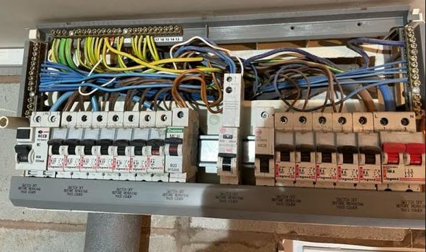

Ok, let's look inside....
The next instalment of the chicken and egg mystery 1668080839776 - EletriciansForums.net

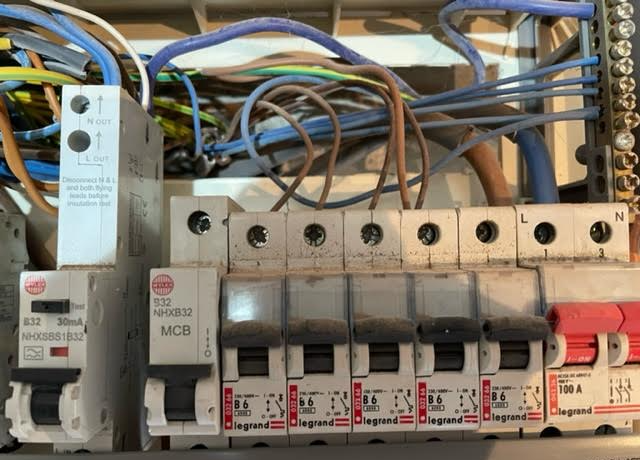

So apart from mis-matched devices, being held by one dry-wall screw to the ceiling, wiring stretched to the limit, and IP rating being seriously compromised, it's fine!
Then I saw it:
The next instalment of the chicken and egg mystery 1668080889128 - EletriciansForums.net
House is and always has been PME. I'm very familiar with this estate and they are all Legrand normal split load boards. Why the ---- is it a100ma device?!?! Surely that's got to be someone messing up when replacing a failed RCD?
Anyway, a new RCBO board would solve a lot of issues, as hopefully the Neutral's will then reach. And they are only using 12 ways so a smaller board should fit. I have a feeling there's some fun ahead here.

Now i'm no builder... and please correct me if i'm wrong..... but shouldn't there be a lintel above that door?
I think there's an I-beam RSJ, I could see the bottom of it above the door and it looks as though all of the blocks have been disturbed about it.
That could well introduce further fun - we'll see!

It could be that they put the 100ma in because they were getting nuisance tripping and thought it to be a good idea.
so what's to the right of the CU? A spur and flex to an outside light?
One of those 'builders' that doesnt really follow any guidelines and a homeowner that possibly didnt tell the council planning dept what they were planning?
Ive got houses in my street where the homeowners have cut through their understairs WC, fitted a door and made an entrance into the garage.....
Yep, and I was wondering how that passes through an RSJ - if there is one!

They have just moved in. And it highlights how useless surveys are. They were going to buy a basket-case house that needed virtually rebuilding so they paid for a top-price 'full' survey. Then when it fell through they couldn't get a refund so requested a different address, the property in question.
I was then shown the 129 page survey. In the electrical installation section there's a photo of the CU, exactly as above, and it says "The garage consumer unit appears to be in a safe and serviceable condition" 🤣😂
It does then add the usual blurb about getting it inspected by a competent person as it's impossible to assess safety without ripping the place appart.
Now I know survey's are pretty water-tight about washing hands of all responsibility, but this one must be close to legitimate grounds for complaint when it's so obviously been monkeyed about with!
I asked whether the solicitor had picked up building regs / planning permission for the door during the purchase, or whether they got an EIC when they got the kitchen done as the board sticker is 2006. No to all of that.

Did you find out as to the reasoning of the 100ma rcd ?
