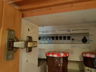

I think there’s a serious issue with this installation, and it’s going to be tricky to solve. The customer will need to be aware of additional costs early.
would love to see photo of CU as it is now with whatever’s in front of it.
If the fault is coming from an AC system, like in a house, then the fault current will be AC.
Here you go.. best shot of it that I took. Why do you think it will be tricky? Is it not likely to be a N-E fault, so standard fault finding?
