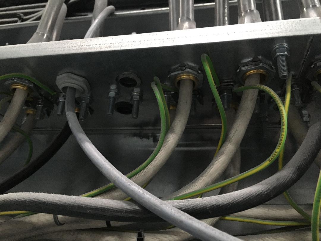

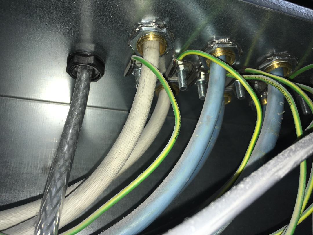

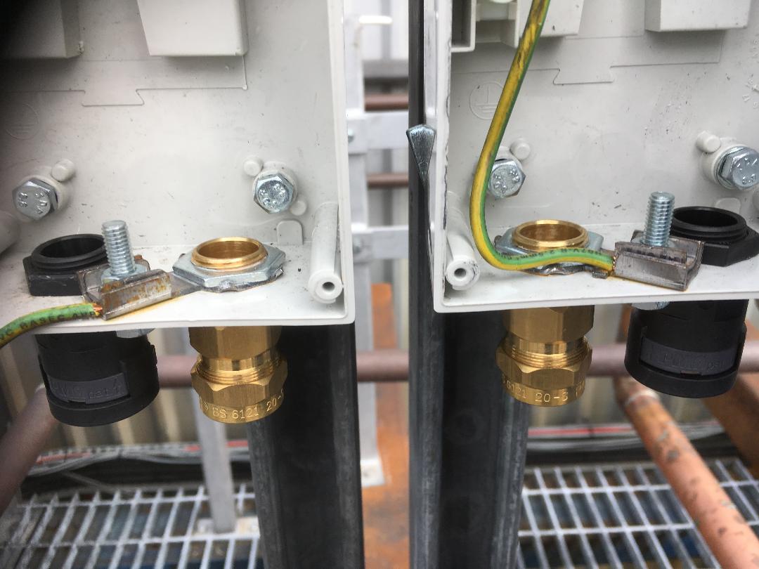

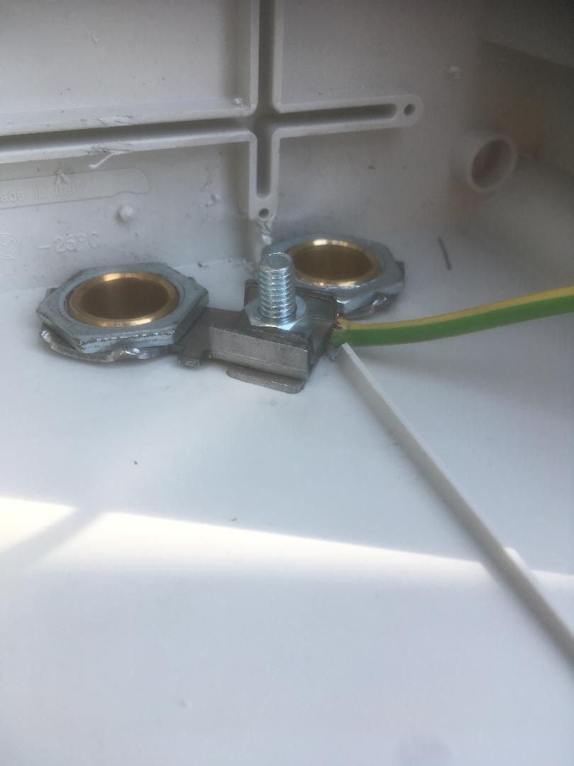

Hi I have been in the electrical contracting industry all my working life 40 years and became a member of the NICEIC in 2006. During this time I have come across many problems within installation work does this sound familiar.
Have you ever like I have on numerous occasions been installing armoured cable and had difficulty tightening the gland body and locknut together onto the enclosure whereby you start to tighten the gland body and the locknut continually slips around and around on the inside of the enclosure . Then you try and get a second spanner or grips to hold the locknut which is very awkward and manufacturers make the locknuts so thin these days its almost impossible to grip, you eventually get the gland and locknut as tight as you can and then continue to make the armoured cable off into the gland, you begin to tighten the nut onto the armouring and everything starts to turn the gland and now the cable, its the last thing you want.When this happens its very frustrating and time consuming. There are two things you can do, you can resort to using an old screwdriver and try to hammer the locknut tight not very professional and could cause some damage if using a plastic enclosure, or take it all apart and start again not very good if you have got a long piece of cable going through the gland and you have got to try and get them tight again.
We all know how important it is to achieve good continuity between the armour and the gland especially if the armour is acting as the CPC which is acceptable in most cases an example being a TP+N+E using 4 core cable. I have found a solution for this problem its the TME 20 G. Its a type of bracket which fits between the inside of the enclosure and the locknut, there is no extra drilling involved you drill your 20 mm and 6mm holes as normal insert the gland body with the earth tag through the 20mm hole you've drilled put the TME 20 G over the thread on the inside points facing the locknut then loosely put on your locknut ,line up the 6mm holes on the earth tag, enclosure and TME 20 G insert the 6mm hexagon bolt and washer into the 6mm hole then the square washer and 6mm flange nut on to the hexagon bolt inside. You can then hand tighten the gland body then use your spanner to pinch it up as tight as is required no messing with the two spanners just one on the outside of the enclosure its simple its tight and is definately not going to spin. If you take a minute to think its almost the same as you would normally assemble an armoured cable gland the only extra part is the TME 20 G bracket.
The TME 20 G also provides a convenient connection for your circuit protective conductor where you can insert the bare conductor directly under the square washer or use a ring terminal blue or yellow 6mm or a crimped lug up to 16-6. Once again only one spanner required to tighten this connection again from the outside of the enclosure as the serrated flange nut holds its self once hand tight.
The TME 20 G comes in a pack of two of each of the following - 20mm brackets[GS], square washers[GS], serrated flange nuts[BZP], 6mm x 16mm hexagon bolts[BZP], and 6mm form A washers[BZP].
The TME 20 G is made from galvanised steel and another advantage is when using plastic enclosures, the 20mm bracket provides extra mechanical strength around the gland and under earth tag and the connection for the CPC ensures good continuity.
When using two glands side by side with one 6mm hole for the earth tag the TME 20.1 G can be used it is assembled the same way on the second gland as above for the TME 20 G but the end with the 6mm hole is flat and sits between the inside of the enclosure and the U shaped end of the TME 20 G on the first gland. I have attached some images to make it easier to understand how it all goes together.
The TME will eventually be available up to 75mm that is TME 20 G, TME 25 G up to TME 75 G and a brass version will be available TME 20 B and so on.
For any of you who may be interested, as things progress I will provide more information as this product will be available to purchase on line and over the trade counter later this year.

The earth connection is still relying on tightening a nut onto a plastic panel. As above, piranha nuts would be preferable.
Not really you got the earth tag on the outside with the bracket inside they do sandwich the plastic I agree but there is a fair bit of surface area of metal against plastic it tightens up with no problem.

Here are some more images.
I don't see what the issue is here, although the OP could have been more clear about their interest in this. Various solutions exist for all manner of problems - you pays your money and takes your choice.
It might be an idea to approach gland manufacturers as it would be nice to turn up on site and find these inside gland packs. Not easy to reach from the top of a gland plate into a pit beneath and these would make life considerably easier for anyone working on their own.
Why has it got a banjo outside as well as a bolt through ?
I've never been a fan of drilling extra holes for no real benefit that I can think of.
One of the things I could see as being useful is an L shaped banjo that would allow an easy connection to it and also would help with locknut spinning.
